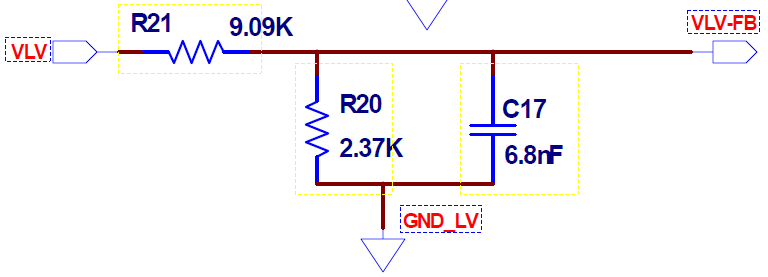

I'm dealing with the ADC circuit for TIDM-BIDIR-400-12.
In the TIDM-BIDIR-400-12, there is an output voltage sensing circuit.
It consists of the voltage divider and RC filter I guess.
The image below is the schematic of the circuit.
As you can see the image, I guess R21 and R20 work as a voltage divider and R21 and C17 work as an RC filter.
I want to ask for several things.
1. What's the intention of the resistor R21 and R20 value? Is it because when the 12v output voltage reached, the designer wants to give the ADC voltage 2.5V?
2. What's the role of R11 and why that resistor value is 49.9? Is it related to the Input impedance of the f28035 DSP adc port?
