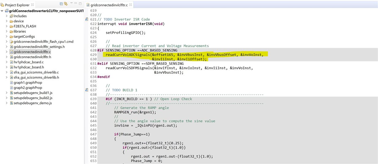

          I am sensing a single phase offseted AC voltage from the grid. and using the PLL library to synchronize with it. But the spll1,theta[0] output is giving a 250 Hz saw tooth waveform.
My ADC ISR time period is 21us. Please help with the synchronization. I have enclosed the code below:
