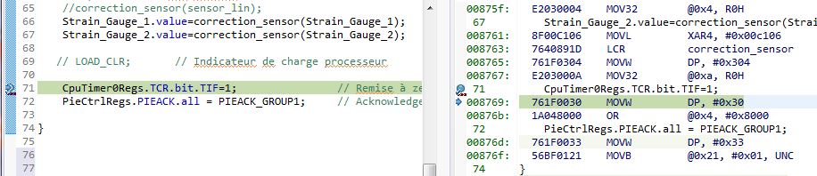

    I think yes , but I add a capture of the disassembly , with a breack point a the end of my interruption.
    I also found this in your forum it was my case.
    The function exit is called when main has completed.  Note how exit ends by calling the function abort, and abort ends with a spin loop.  In most embedded systems, the function main should never finish.  Is this the case in your system?  If so, then you need to work out why the main function somehow completed.
    Alain.

    I’ll take it from your answer that the ISR indeed is returning with an IRET instruction.(I don’t see the IRET captured in your snapshot though. Would be good confirm via snapshot whether it is an IRET or an LRETR).
    It is true that once the main finishes, the exit routine will be called(part of the compiler code). It is very likely that sometimes if the compiler optimizations are enabled and the interrupts are not correctly configured, the compiler treats it like a usual function call instead of an ISR. I am certain that the end of your ISR(interruption) is an LRETR as this seems to be the only logical explanation for the function to come out of main and move on to the exit routine which contains the abort function.
    Since you mentioned that it works on the project from controlsuite, I suggest you make compare the project properties from the control suite with your project properties. That will give you an idea on what the difference could be.
    You could try turning off the optimization from the project settings if in case it is enabled.

  • ALAIN,
    IRET and LRETR are kinds of return instructions for C28. IRET is called when you return from an Interrupt service routine. LRETR is called when you return from a normal function call. More details on these instructions are described in the C28 architecture manual. http://www.ti.com/lit/ug/spru430f/spru430f.pdf.
    The disassembly window snapshot which you have posted does not have either of these instructions. This is not clear from the snapshot. If you could put up the snapshot of the disassembly around the end of your ISR, that would confirm what kind of return instruction you have. Whatever snapshot of the disassembly you have put so far shows the disassembly till the last instruction. My point of interest is what happens after that.
    My guess is that if you have an LRETR at the end of this function, it would return to the function which was last called and that could be your main. Hence you might be seeing it coming out of the main function and execute the abort function.
    Please check the following:
    1)      Check for the return instruction from the ISR like I explained above.
    2)      Check for the project properties if you have enabled any optimization and disable it once if enabled.
    3)      Also, since you mentioned that it works on the project from controlsuite, I suggest you make compare the project properties from the control suite with your project properties. That will give you an idea on where the difference could be.
