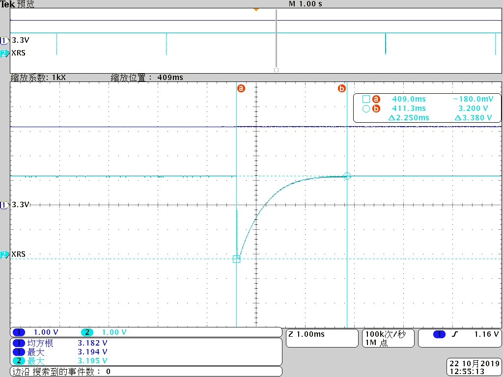

         First time we discovered this Reset regularly issue,  we changed the chip and downloaded the software again (without changing the system board).the whole system board was working normally without put into end equipment(motor control box in air conditioner).
        However, the reset issue happened again after we put the system board into the end equipment(motor control box in air conditioner).
         After removing the low-voltage reset chip in the system board, we monitored the 3.3V and XRS pins. The waveform is as follows: (it can be seen that XRS has the regular pull-down waveform issued by the chip) it is determined that the chip is repeatedly reset.
         The green line is XRS PIN, and the blue line is 3.3V VCC PIN. Could you help me analysis why does this happen?
