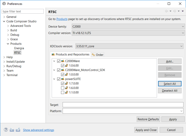

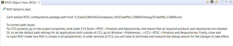

I want to use ROV classic to analyze the runtime memory for TMS320F28069. when I clicked Tools -> ROV Classic, it popped out a screen as below:
after I clicked OK, it shew a screen as:
I set up it as:
Then i click Apply and Close. It shew a screen as below:
Can you let me know how I set up and use ROV Classic for C2000 (TMS320F28069F)?

Hello Hao,
Is your application a SYS/BIOS application? The ROV would only work with those applications.
http://dev.ti.com/tirex/explore/node?node=AKZHe6TTjJczkCLZOAs-2Q__FUz-xrs__LATEST
