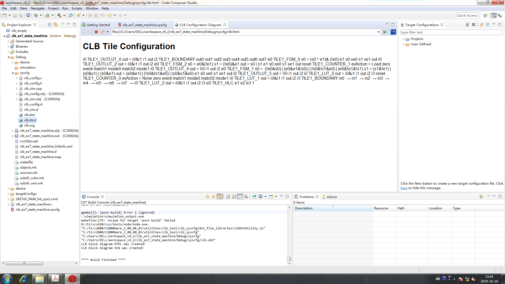

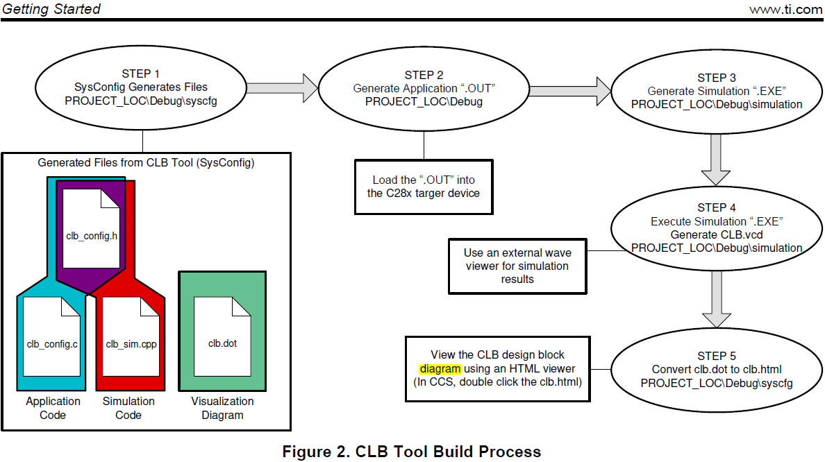

Hi all,
As mentioned in CLB Tool User Guide, clb.dot is a Visualization Diagram, view the CLB design block diagram using an HTML viewer (In CCS, double click the clb.html)
But when i double click the clb.html, no graphics are displayed, it is shown below:
What is the cause of this?
I hope you can help to judge the cause of the problem. If you need to provide some information, please let me know.

Thank you for your notice.
I reimported and compiled the project, all compilation information is shown below
It looks like there are no errors in the compilation, but you still can't see the Visualization Diagram.

Everything seems to build correctly can you send me the .SVG file and the .HTML files?
Nima
Dear user,
I have tested this multiple times and it seems to operate as expected.
The steps for generating the HTML is line 55 of your build command. It uses a javascript library along with NODE.js
If your issue persists please post your HTML, DOT and SVG files.
Nima
Dear Nima:
Thank you for your help!
Maybe there's something wrong with may operating system.
I replaced a computer and got the correct results.
