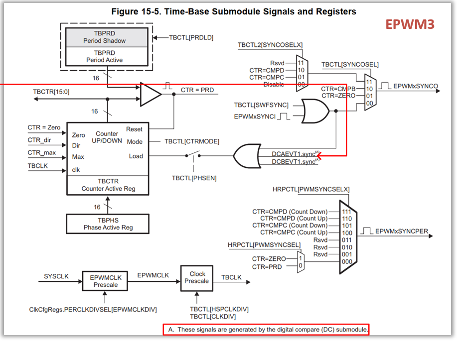

I am using TMS320F28379D as controller for a DCDC converter, the ePWM modules in my hardware are assigned as: ePWM1 and ePWM2 are run at a variable frequency fsw1, ePWM3 to ePWM8 are run at another variable frequency fsw2
The issue I encounter is that when I try to change the frequency of ePWM3~ePWM8, an unwanted phase shift between ePWM3 and ePWM4 happens , I believe that is caused by the synchronous scheme in TMS320F28379D, the ePWM3 and ePWM4 are in different sync group.
My solution is, sine the hardware cannot be modified, I am  going to use the ePWM-XBar to feed the SYNCOUT signal from ePWM4 to synchronize ePWM3, and disable the EPWM2SYNCO signal. The detailed signal loop will be: EPWM4SYNCO -> ePWM
-Xbar -> Digital compare module of ePWM3 -> Time base module of ePWM3. The signal loop is showing in the figure below:
Fig.1 ePWM4 to Xbar
Fig.2 X-bar to Digital compare module of ePWM3
Fig.3 ePWM3 Digital compare module to TB module
The codes I have now is listed below:

    //****** Sync EPWM3 with EPWM4 though X-bar *******//
EALLOW;
     //Select sync output
     SyncSocRegs.SYNCSELECT.bit.SYNCOUT = 1;        //Select EPWM4 SYNCOUT as EXTSYNCOUT
     //Configure source of TRIP4
     EPwmXbarRegs.TRIP4MUX0TO15CFG.bit.MUX14 = 3;   //Configure TRIP4 to be EXTSYNCOUT
     EPwmXbarRegs.TRIP4MUXENABLE.bit.MUX0 = 1;      //Enable
     EPwmXbarRegs.TRIPOUTINV.bit.TRIP4 = 0;         //Non-invert, active high
     //Configure DCA to be TRIP4
     EPwm3Regs.TZDCSEL.bit.DCAEVT1 = TZ_DCBH_HI;    // active high
     EPwm3Regs.DCTRIPSEL.bit.DCAHCOMPSEL = 3;       // 0b0011:TRIPIN4
//     EPwm3Regs.DCAHTRIPSEL.bit.TRIPINPUT4 = 1;
     //Configure DCA path to be unfiltered & sync
     EPwm3Regs.DCACTL.bit.EVT1SRCSEL = DC_EVT1;     //Unfiltered EVT1
     EPwm3Regs.DCACTL.bit.EVT1SYNCE = 1;            // Sync enabled
EDIS;
But my test result shows it doesn't works well, when I change the period in a epwm1 interrupt,  ePWM3  and ePWM4 can only be synchronized when the changing step is small, for example EPWM_TBPRD changed from 500 to 510, and it fails when the step is large, for example  EPWM_TBPRD changed from 500 to 600.
Anyone could help me figure out what's the problem with my solution? Or if you have any better idea? Many thanks!
