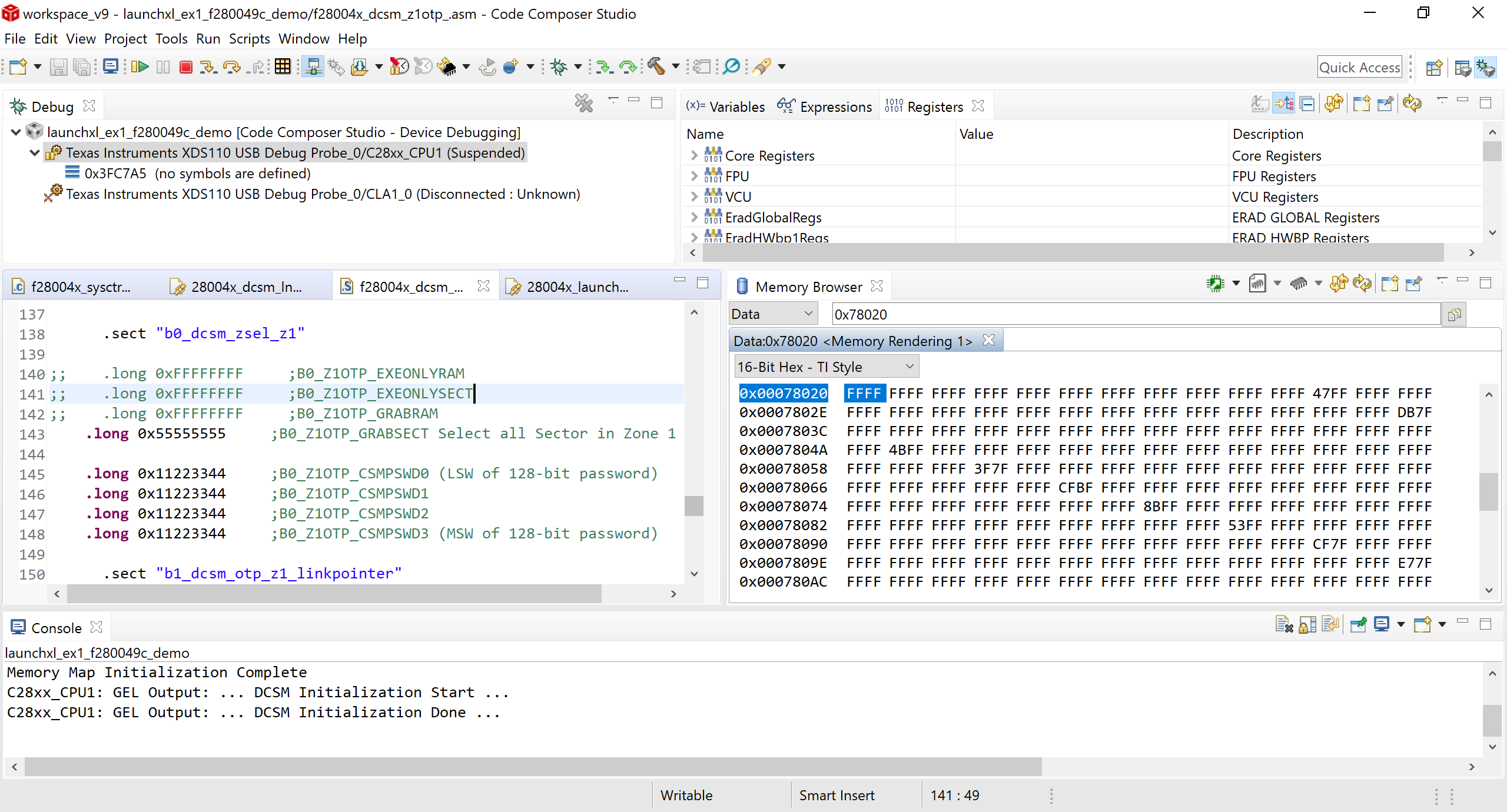

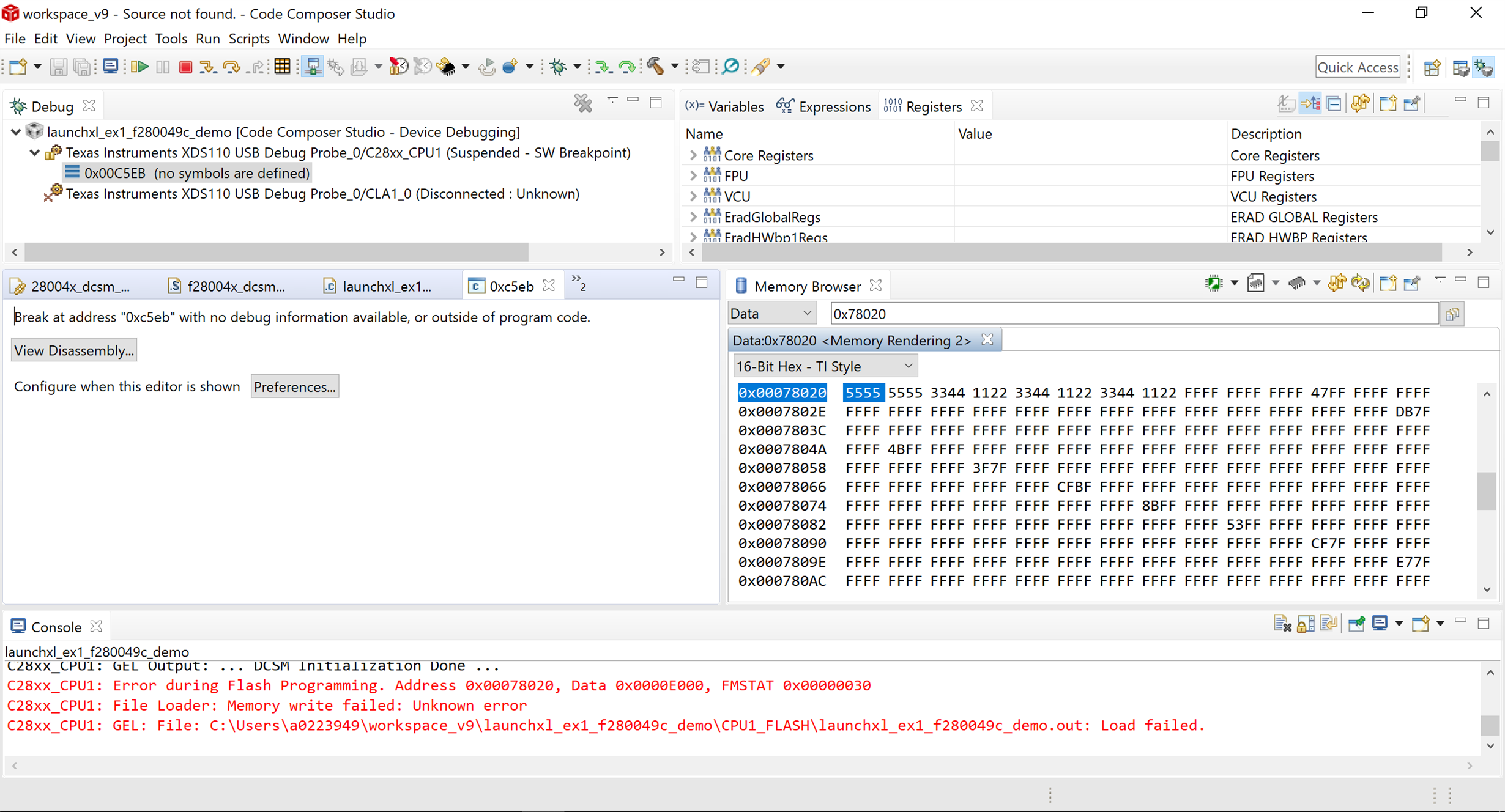

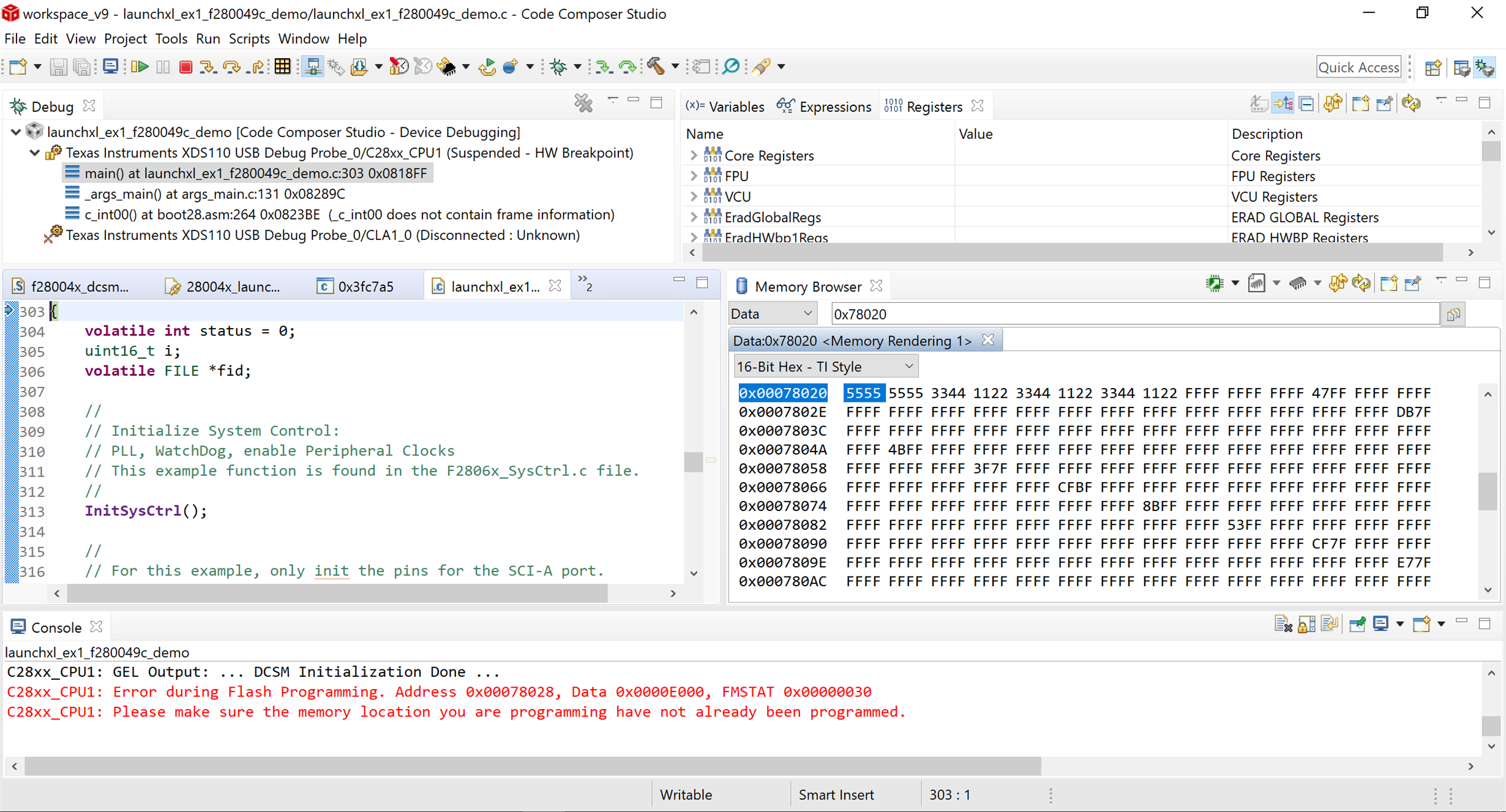

Hi expert,
I am tring to lock F280049 with the provided asm file and cmd file but it seems goes to wrong location. Here is the asm file I modified and memory content.
It seems not to the right position, what happens here?
Attached the cmd and asm here.
CMD:

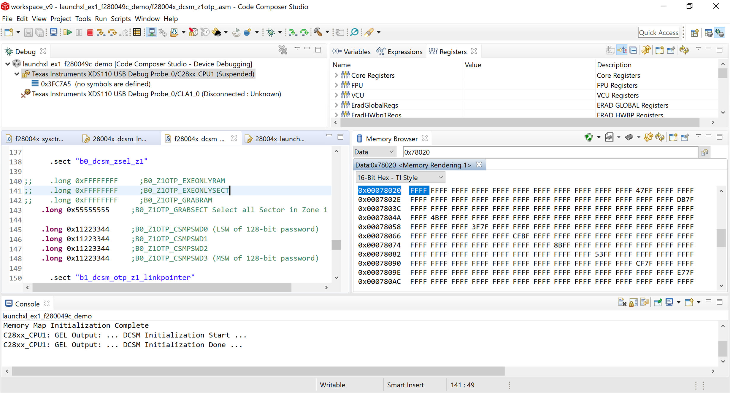

      .sect "b0_dcsm_zsel_z1"
    .long 0xFFFFFFFF     ;B0_Z1OTP_EXEONLYRAM
    .long 0xFFFFFFFF     ;B0_Z1OTP_EXEONLYSECT
    .long 0xFFFFFFFF     ;B0_Z1OTP_GRABRAM
    .long 0x55555555     ;B0_Z1OTP_GRABSECT Select all Sector in Zone 1
    .long 0x11223344     ;B0_Z1OTP_CSMPSWD0 (LSW of 128-bit password)
    .long 0x11223344     ;B0_Z1OTP_CSMPSWD1
    .long 0x11223344     ;B0_Z1OTP_CSMPSWD2
    .long 0x11223344     ;B0_Z1OTP_CSMPSWD3 (MSW of 128-bit password)

  • My target is to lock all flash sectors in zone 1.
  • Hi Sheldon,
    Are you getting any warning during code compile? Did you check the map file to make sure the mapping is at correct address?
  • Hi Vivek,
    I have checked, the build process gives no error and warnings.
    Today, I gives another trial shown as below (comment out some lines in asm file), and meet similar issue as yesterday.
    1. This is what I see before loading program, just by connecting the debugger. Notice I comment out some lines here.
    2. After loading the code I get error in the console and have below memroy conten read.
    3. I tried exit the current debug process and re-connect the target, memroy shown below.
    4. Tried to reloading the program but get this error.
