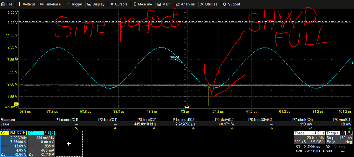

we are using a F28075 device Sys Clock running at 100 MHZ, ePWM running at 100 MHz to generate a 16 KHz period sinusoidal waveform using ePWM6 (carrier 450 KHz) to control a bulb filament current
- ePWM6 generates an INT every time cntr = 0 and a SOC signal to convert the current (i_fil) at 2x 16 KHz and to launch the PI control for i_fil (CLA Task4)
- CLA Task3 updates ePWM6 CMPA with CLA RAM sine table: 450 KHz (every ePWM6 INT). This task takes 300 nS to get done (<<< 2.222 uS period)
- CLA Task4 modulates sine waveform, 16 KHz (every i_fil EOC). This task gets 1000 nS to get done (<<< 62.5 uS period)
- ePWM6 Period and CPMA are configured in Shadow Mode
We get a ePWM6 signal period varying between 2.22 and 2.62 uS (jitter) when CLA task is copying the corresponding sine table value from CLA RAM to CMPA reg, but it should be constant. The only thing that should be changing is the signal duty cycle. The consecuence is a wrong sine wave. The debugger shows that sometimes SHDWAFULL bit is 1 when updating CMPA at CLA Task3
Tests:
  1. if CLA Task 4 is NOT modifying CMPA reg. (Init CMPA=HALF_PERIOD) --- > period = 2.22 uS (450 KHz) perfectly constant, no jitter,
  2. if we copy HALF_PERIOD - sine_index (0-27) instead of sine table value into CMPA we get period jitter also and a triangular wave
  3. Disabling High Res PWM
  4. Disabling all clk ePWM modules int the app but ePWM6 one
  5. Decreasing CLA Task rate to 150 KHz. The jitter decrease, but still present
  6. Changing into “inmediate” instead of “shadow” mode for ePWM6
  7. if SHDWAFULL bit is 1 we set a GPIO output to Low for a several nops time to show the situation in the scope. The sine wave seems to be OK when that bit is 1, but sometimes is wrong when the bit is zero.
  8. if SHDWAFULL bit is 1 we don’t update CMPA. The sine is even worse
None of the above tests fix the jitter problem
QUESTION: Can CMPA be written at a high rate like ePWM period?
Project code is attached (FilControl.zip)
the ePWM config and CLA tasks code is below
Figure 1. the sine wave is not correct in the red arrow area (it is corresponding with a wrong PWM period) but bit SHWDFULL (yello signal, C1, active low) is not active
Figure 2. Shows that bit SHWDFULL (yello signal, C1, active low) is 1, but the sine wave is perfect
  Figure 3. Shows that is we don’t update CMPA when SHDWA bit is active the sine wave gets even worse than updating it (comparing with figure 2)

  • Agustin,
    I was unable to build your code.
    To make sure you have two issues correct?
    1. The PWM's period is changing unexpectedly.
    2. The CMPx register is not getting updated consistently.
    Lets try to correct the PWM's period jitter first.
    I didn't see that you were using HR period, is that correct?
    Please place a hardware watch point on TBPRD and see if that value is changing.
    Cody
  • Hi Cody,
    "Lets try to correct the PWM's period jitter first"
    As the PWM is in Up-down mode and the PWM is symetric, the period change can be due to changes in CMPA when cntr=0. I will try to check the period using output signal A (is a spare output in my HW) and cntr=0 and cntr=CMPB events which are independent from CMPA (sinusoidal table)
    Yes, I have deactivated it for testing purpose, but it was used in the past with the same result
    So let me re-phrase the issues:
    - SHDWAFULL bit is active several times
    - sometimes Task3 (450 KHz) takes more than 2.22 uS (1/450KHz) to get done
    "Please place a hardware watch point on TBPRD and see if that value is changing"
    Done. It never changes
    Thanks for your fast response
    Any suggestion?
    Agus
  • Agus,
    I believe that varying CMPA will only change the duty cycle, it will never change the period. That being said, if you are calculating the period off of the middle of the High pulse, then the period number could jitter, but in reality the period is the same.
    If the shadow full bit is being set it seems like you are able to write the shadow register faster than you are sending load-strobe pulses.
    Do you know when Task3 slows down? Do you have anything that could be causing contention and slowing down Task3?
    Cody
  • Hi Cody,
    would you mind answering this question?
    How fast can be the CMPA register be updated? More than 450 KHz? (PWM clk is 100 MHz)
    Regarding:
    my observation is: I am not sending any load-strobe pulses as they are sent by the EPWM device itself. So that, I don't know how fast I can write in CMPA register
    Thanks in advanced
    Looking forward to hearing from you
    I didn't explain previously why the period of my resulting PWM6_A signal waveform is depending on CMPA.
    As you suggest,the PWM period register is constant EPwm6Regs.TBPRD = FIL_PWM_PERIOD which is something completly different from the period of signal A that can be measured using two consecutives rising edges
    The problem I have is that EPWM6_INT launches CLA Task3 and the period of Task3 should be FIL_PWM_PERIOD (2.22 uS) but it is not. Sometimes I measure 2.62 uS
  • Agustin,
    When using shadow loading it can only be updated once or twice per period. I think technically if you wanted to you could update a period, zero, and a SYNC event. But, honestly I cannot think of a reason why you would want to update your values more than twice per period.
    Correct, you do not send the load strobe, but you can configure when the load-strobe is sent with LOADAMODE.
    Cody
  • Hi Cody,
    I found the problem why I had SHDWAFULL active
    I was writting accidentaly to CMPA reg in the CPU. The app was meant to modify CMPA register only at CLA Task 3 every PWM period
