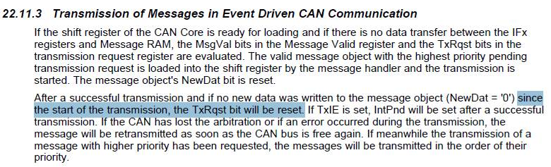

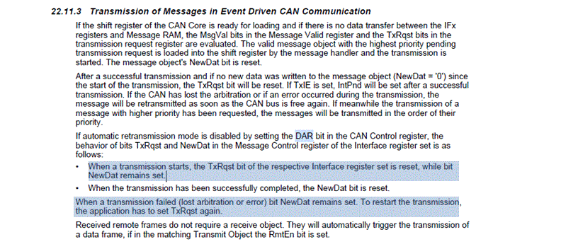

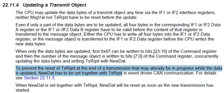

1. According to TRM chapter 22.11.3, it says that set the TxRqst with NewDat during transmission. The TxRqst is set right after the start of transmission with NewDat remaining set.
    The NewDat will be reset once the transmission is successfully finished. However, the end of chapter 22.11.4 says that when NewDat is set together with TxRqst,
    NewDat will be reset as soon as the new transmission has started.  Why are they in totally different?

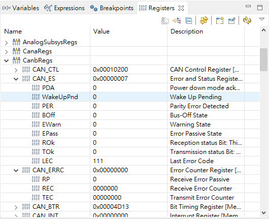

2. Since the chapter 22.11.3 and 4 say that the TxRqst and NewDat are both have the chance to be reset by CPU, however when I work my project on 28377D,
    it seems that TxRqst and NewDat is never been reset anymore once I raised them. How is it happened? Is there anything configuration I did wrong?
    I am sure that the SINGLE CAN packet is successfully transferred by CAN king.
    And I just let CPU process to stuck in an infinite while loop for a short time before I pause the debug to observe the register status.
3. According to TRM chapter 22.11.5, to achieve the continuous transmission, TxRqst can be set with NewDat.
    Then we can directly update the data register without the reset of TxRqst or MsgVal.
    However, this method has a shortage that the packet failed to transfer cannot be re-exported. I did an short experiment and find out it is true.
    Is there anything method to realize the continuous transmission without this side effect?

    >>1. According to TRM chapter 22.11.3, it says that set the TxRqst with NewDat during transmission. The TxRqst is set right after the >>start of transmission with NewDat remaining set.
    >>    The NewDat will be reset once the transmission is successfully finished. However, the end of chapter 22.11.4 says that when >>NewDat is set together with TxRqst,
    JC:  Section 22.11.3, NewDat will only remain set if DAR is disabled or there is a loss of arbitration/error
    >>2. Since the chapter 22.11.3 and 4 say that the TxRqst and NewDat are both have the chance to be reset by CPU, however when I >>work my project on 28377D,
    >>    it seems that TxRqst and NewDat is never been reset anymore once I raised them. How is it happened? Is there anything >>configuration I did wrong?
    >>    And I just let CPU process to stuck in an infinite while loop for a short time before I pause the debug to observe the register >>status.
    JC:  To confirm that transmission of the packet by F28377D CAN did take place, is there a node that is able to receive the packet.  Your screen capture shows that the F28377D CAN transmitted 4 bytes with a value of 0x0C100040.  Just curious to see if this packet ever made it to the CAN bus so a receiving node can confirm it if it has the same CAN data.  I'm assuming this is what CAN king received?

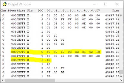

    RT: Well, I should stretch the register window to let you see the IF1DATB. But I can promise that the data recognized by CAN king is correct. You can see the figure as follow. At least the IF1DATA is correctly displayed on the CAN king output window.
    (Since IF1DATA is 0x0C100040.)

    Thank you for providing the snapshots.  These help a lot with the explanations.  Did you get a chance to poll the CAN_ES and CAN_ERRC registers in the CCS register window after transmission?  Maybe they will indicate something related to item# 2 as to why TxRqst and NewDat are never reset although it shows in your CAN king results that data transmitted correctly.

    Here is the CAN_ES and CAN_ERRC registers snapshots. Does it help?

    TxOk is '0' in CAN_ES register means that there was no message that transmitted successfully.  That is probably why TxRqst and NewDat is set in item #2.  I'm not familiar with CAN king but does it acknowledge receiving a CAN?  Maybe it needs to be configured so that it will acknowledge the CAN message.  If there is no acknowledgement from a receiving node then i believe TxRqst and NewDat will remain set.
