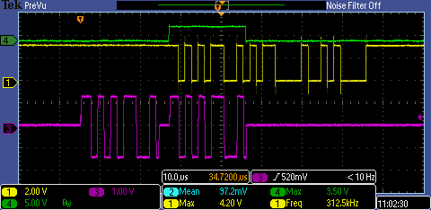

I have a basic a setup of a master-slave system, where the master is sending a predefined message to the slave and the slave echo backs this message. Both master and slave  the same microprocessor TMS320F28021DAS of the family TMS320F2802x, and they are communicating to each other through RS-485 transceiver SN65HVD1781.
I have a doubt concerning the signal generated by the microprocessor and sent to the transceiver. As shown below, the green trace shows the enable signal (of master) during the data transmission in yellow (8 bit message predefined to 00110101b). This yellow trace is going through the transceiver input, and pink trace corresponds on the transceiver output in differential. After a short rest period, we can see the slave sending back the message.
MASTER TRANMSSION
SLAVE TRANSMISSION
My question is: if I have configured my code to send an 8 bit character with 1 stop bit, why does the sent signal by TMS320F2802x (yellow) look like that? It seems to send two times the messages and after it has some random values. Where is the stop bit? Is my peripheral configuration correct?
FYI, the master and slave understand each other, in debug mode RXTX fifo registers have the correct value (00110101b).
Any help is welcomed. Thanks in advance.
here is my code :
You can find the master configuration code I did just below:

  • Aurelien,
    The code based on the F2802x drivers is being deprecated.  Please try your experiment using the bit field header files (structs) and we can provide better support.  In general, we do not review or debug user code, but we will provide assistance to you with specific issues relating to our devices and development tools. This includes clarifying the behavior of any bit, register, or features when designing with our devices. Please note that all peripherals have example code in C2000Ware. We suggest comparing your code to the example code to determine where the problem may exist. It is recommended to follow standard and logical debugging techniques. Please continue to debug your code and feel free to use this forum to ask specific questions. The more specific the question, the better we can assist you.
    - Ken
  • Dear Ken,
    Thanks for your reply. I will have a look and compare with C2000Ware codes as you suggested.
    I was not expecting that someone deb-bug the code. I attached the code and Scope shots only for illustrating my problem.
    Based on the waveforms and may be your expertise or cases you might have been already facing with other users, I was hoping some suggestions or basic verification may be already given.
    Thanks.
    Aurelien
  • Aurelien,
    I check with some colleagues and we do not understand why the FIFO would send the same information twice or anything about the random values after that.  We can only suggest trying the structures, which you are doing.
