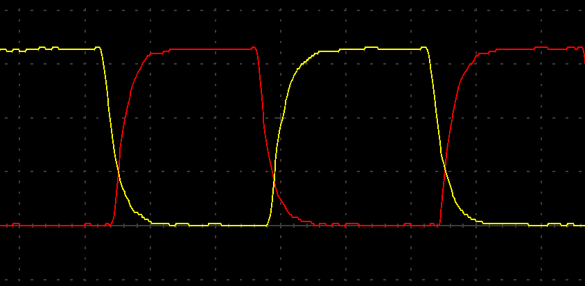

I configured dead time at 18.75ns between PWM1A and PWM1B. Dead time is working. but the problem is that I set the duty of PWM1B to 0, but despite this, it is inverted relative to PWM1A.
I need no inversions.

  • Max,
    I have not reviewed you code, however is suspect that you have configured the DB to be in a complementary mode and now are trying to force ePMWxB low using the Action Qualifier(AQ)submodule.
    If this is the case: Please note that the submodules of the PWM take effect sequentially. The AQ takes effect before the DB. Then inside of the DB you had told it to discard the ePWMxB channel generated by the AQ and create a new ePWMxB output which is generated from the ePWMxA input with a known DB.
    If you wish to shutdown the PWM I would suggest looking at the Trip-Zone submodule, which takes effect after the DB.

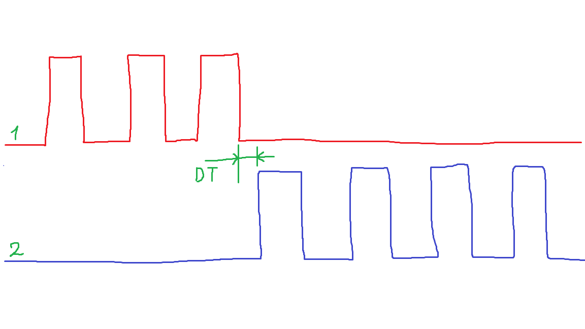

  • I do not want to completely turn off channel b, I want to turn it on regardless of channel a. In this case, deadtime should be as in the figure:
  • Max,
    Use the trip-zone submodule to force the PWM output low for each A or B channel when you want that to happen.

    Try changing the deadband configuration to active high instead of active high complementary.
    Looking at the last waveform you have drawn it might just make sense to not used the Dead-Band submodule and to add the deadtime in the Action Qualifier. Just a thought, but it un-links ePWMxA and ePWMxB and you could use the AQSFRC or AQCSFRC to force the PWM's output low.
