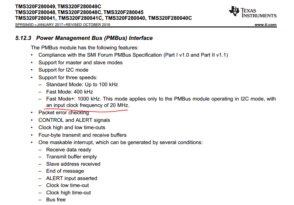

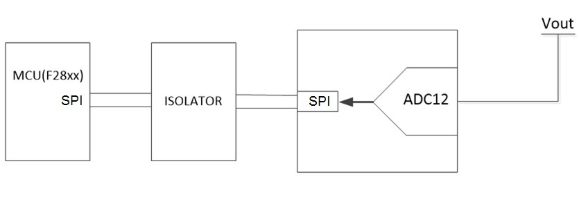

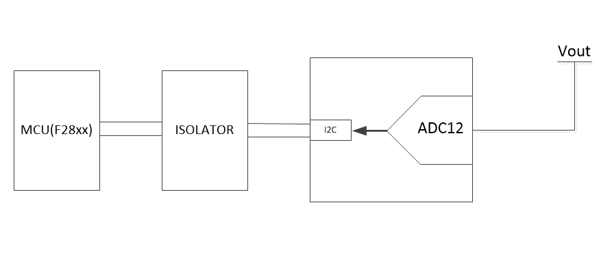

Dear c2000 expert,
I'd like to have a 1Mhz I2C speed with using 280049, here I see a pmbus interface could works at 1MHZ, but it needs to config it as i2c mode, and with input frequency of 20MHZ. My question how to config the input frequency to 20MHZ? Where the 20MHZ frequency comes from?
