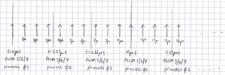

Can someone please offer software structure suggestions on how I can realise the following for a Bi-Directional Interleaved Buck-Boost DC/DC Converter operating at 100kHz.
EPWM1 and EPWM2 = Phase 1 (0deg)
EPWM3 and EPWM4 = Phase 2 (120deg)
EPWM5 and EPWM6 = Phase 3 (240deg)

The ADC is triggering on EPWM7.
There are 3 CLA tasks plus a fourth for initialising variables.
CLA Task 1 is used for Inductor current processing (trigger on ADCA1).
CLA Task 2 is used for voltages and currents processing (trigger on ADCB1). This is where the 2p2z will be unless recommended otherwise.
CLA Task 3 is used for temperature processing (trigger on ADCC1).
I'd like input in how I can correctly initialise the ADC.

  • Understanding that the ADC sampling can be synchronized to a specific phase of a PWM, the input/output voltage/current values (4 in total) are required for EPWM1/2, EPWM3/4 and EPWM5/6. From what I understand, the ADC can not have multiple sources of triggers. I have used EPWM7 sampled at 300kHz (3 x 100kHz) to capture points in this sequence and monitor TBPRD to process the correct phase at a particular point in time. Currently, I have EPWM1 set to the master to synchronize all PWM signals including EPWM7. Is this the correct method for synchronizing all PWM's?
    I have updated the CLA tasks to generate an interrupt at the end of an ADC conversion. The following is using EPWM7 as the trigger source.
    CLA Task 1 - Iin
    CLA Task 2 - Vin
    CLA Task 3 - Iout
    CLA Task 4 - Vout
    Each of the above tasks perform a 2p2z biquad filter however, post processing is required once all the four parameters have been converted. I would like to perform the post processing on one of these tasks only. Should I make (say) Task 4 the least priority ADC conversion and then perform the post processing in this task? Your thoughts.
    The below tasks are triggered on CPUTimer0 at 900ksps.
    CLA Task 5 - Inductor current phase 1
    CLA Task 6 - Inductor current phase 2
    CLA Task 7 - Inductor current phase 3
    After each completion of the tasks, I toggle a pin on the uC to check timing correctness. With all the above running, there is misalignment and my CPUTimer1 (used to process CAN functions) no longer operates. Furthermore, between Task1 and Task 2 there is a lag of approximately 1us and it appears the other signals are not synchronized. Is this expected? When I reduce the ADC trigger frequencies in the kHz region, there is no misalignment however, there is still a 1us lag between signals.
