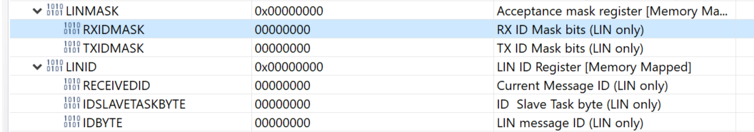

  • Hi Nirav,
    I have tried polling using below lines:
        while(1){
                while(LIN_isRxMatch(LINA_BASE)){
                    // Read the received data in the receive buffers
                    LIN_getData(LINA_BASE, rxData);
    But I can't receive any ID from the master. Registers screen shot shown below.
    In the demo, I modified loopback example to continue send data, and the waveform on TX pin seems good. But the slave can not get over the "LIN_isRxMatch" API. I have attached the C file of the slave and the master. Could you help me check where the error comes and how to fix it ?
    LIN master and slave.zip

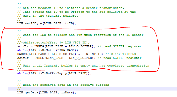

  • Hi Sheldon,
    Try adding highlighted code, I have tried this at my end and I see the ID being received and RXRDY flag being set .
    Nirav
