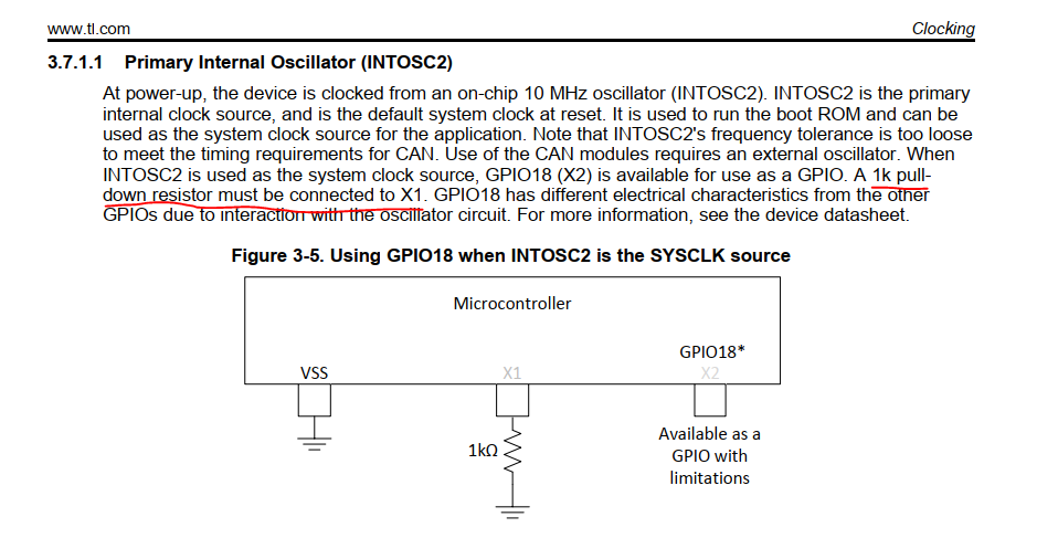

  • Hi Joseph,
    One more questions about the X1 connection if internal oscillator was used, I see that TRM suggestion it should be pull down to VSS with a 1k resistor, but datasheet suggest tie to VSS directly, my qestions is that is the 1K pull down resistor neccessary?
  • Hi Jack,
    The 1k pull-down is only necessary if using X2 as GPIO18.
  • Thanks for this info.
