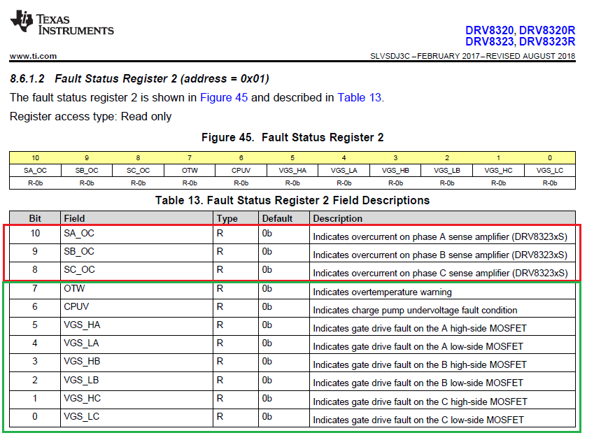

  • Hi
    What I'm seeing is that a tripFault occurs after setting motorVars.flagRunIdentAndOnLine = 1.
    This is due to HAL_getTripFaults(halHandle) !=0), in turn setting motorVars.faultNow.bit.moduleOverCurrent = 1
    ( on Line 544 of is05_motor_id.c )
    When I look at the HAL_getTripFaults() which is in hal.h lines 1226-1233, I see it returns 0x0C (or 1100b).
    //! - EPWM_TZ_INTERRUPT - Trip Zone interrupt was generated
    //!                                               due to the following TZ events.
    //! - EPWM_TZ_FLAG_CBC - Trip Zones Cycle By Cycle event status flag
    //! - EPWM_TZ_FLAG_OST - Trip Zones One Shot event status flag
    Before drilling into this further, I'd like some guidance if possible, for how to proceed.
    Again, I'm trying to run the motor identification lab with 'out of the box' software (no changes made).  I'm using the latest version of the tools, recently downloaded from the ti website, and have been following the lab procedures.
    The motor, while capable of running a high current (~150+ amps at 50V) is being supplied by a power supply that only produces 6A at 50V, however the power never gets anywhere near that level.  The trip fault occurs without the power supply ever registering a single watt.
    Your support will be greatly appreciated.
    Walt
  • You are right, the flag is triggered by the on-chip comparator output or nFault pin of DRV8320RS for over-current fault. The over-current fault is generated by the peak current of the motor phase, which is not equal to the maximum current of the power supply. The board will be damaged if you disable this over-current protection. It seems like the maximum current of this kit is not enough for your motor, you have to design your own board if you want to spin a high current motor over 20A.
    Did you remove the load from the motor during identification? Could you please post the spec. of the motor and the user.h you applied?
    You may try to add the following ccode after HAL_setupDRVSPI(halHandle, &drvSPI8320Vars) to increase the limitation current.
    drvSPI8320Vars.Ctrl_Reg_05.VDS_LVL = DRV8320_VDS_LEVEL_1P880_V;
    drvSPI8320Vars.writeCmd = 1;
    motorVars.dacValH = 4096 - 50;
    motorVars.dacValL = 50;

  • I'd also like to discuss these points you've made:
    1. The over-current fault is generated by the peak current of the motor phase, which is not equal to the maximum current of the power supply.
    2. The board will be damaged if you disable this over-current protection.
    regarding #1) how can we scale the over-current fault, so that we can set it to a known amperage?
    regarding #2) given I'm using a 6A 50V supply, do I need to worry about burning out parts on the board, if an incorrect software value is used somewhere?
    Also, I'm looking into making the following change:
    ------- IS:
    // turn on the DRV8320 if present
    HAL_enableDRV(halHandle);
    // initialize the DRV8320 interface
    HAL_setupDRVSPI(halHandle, &drvSPI8320Vars);
    drvSPI8320Vars.Ctrl_Reg_05.VDS_LVL = DRV8320_VDS_LEVEL_1P300_V;
    drvSPI8320Vars.Ctrl_Reg_05.DEAD_TIME = DRV8320_DEADTIME_100_NS;
    ------ CHANGE TO:
    drvSPI8320Vars.Ctrl_Reg_05.VDS_LVL = DRV8320_VDS_LEVEL_1P500_V;  // rather than 1P880
    //motorVars.dacValH = 4096 - 50;      // currently set to 2048 in hal.c line 673
    //motorVars.dacValL = 50;                  // currently set to 2048 in hal.c line 674
    motorVars.dacValH = 2048+1024;
    motorVars.dacValL = 2048 - 1024;
  • I looked into the proposed code changes:
    It looks like, without making this modification, both the high and low dac settings are set to 2048.  This is noted as mid-point in the code.
    I'm wondering how I can determine the scale used for these settings, and if I shouldn't start with:
    Also would like to know if the test setup is using a power supply fed by 6A at 50V, if we need to worry about damaging the LAUNCHXL or BOOST hardware?
    Can you point me to any literature that describes how the dac scaling is calculated?
    Thanks in advance,
    Walt White
  • 1. The motor identification must be run without load or with a light load, so you can't add any load to the motor, if it has, you should take off the load from the shaft of the motor, because the controller doesn't know the exact rotor position to spin the motor with load during the identification process. I think the motor should be identified or run without load using this board.
    2. Change the Vds limitation value of DRV8320 and motorVars.dacValH/motorVars.dacValL  just for increasing the maximum current protection value to avoid the overcurrent fault. The internal reference DAC value for the comparator will be changed in isxx_xx.c as below codes by the motorVars.dacValH/motorVars.dacValL variables, so that's why to do the setting as mentioned above.
                for(cmpssCnt = 0; cmpssCnt < HAL_NUM_CMPSS_CURRENT; cmpssCnt++)
                    HAL_setCMPSSDACValueHigh(halHandle,
                                             cmpssCnt, motorVars.dacValH);
                    HAL_setCMPSSDACValueLow(halHandle,
                                            cmpssCnt, motorVars.dacValL);
    As the chapter 16 (Comparator Subsystem) of F280049C TRM, the output of the reference DAC can be connected to the negative input of the respective comparator, so set the DACHVALA/DACLVALA  value to adjust the limitation value.
    The value of DACHVALA/DACLVALA is 2048 that means the reference voltage is 1.65V (half of the VDDA), the limitation current is zero since the PGA of F28049C senses the bi-direction current of the motor using a 1.65V offset, The DACHVALA is set to 4095 that means the positive maximum current is half of USER_ADC_FULL_SCALE_CURRENT_A, and the DACLVALA is set to 0 that means the negative maximum current is half of USER_ADC_FULL_SCALE_CURRENT_A.
    So the positive peak current is +(USER_ADC_FULL_SCALE_CURRENT_A/2) if you set motorVars.dacValH to 4095, and the negative peak current is -(USER_ADC_FULL_SCALE_CURRENT_A/2) if you set motorVars.dacValL to 0. But you have to reserve a little bit buffer for both variables, that's why recommend the value as replied above.

    DRV8320 schematic has no external pointer nFAULT LED indicating signal flows into J1 header below. Why haven't you reviewed the booster pack headers today, who would know?
  • It would seem odd configuration CMPSS (GPIO TZ2) when TRIP 7,8,9 are the configured fault inputs.
  • So the TZ2 nFault is for DRV8320 does not necessarily indicates an over current condition, since PGA1,3,5 via CMPSS 1,3,5 monitor OC condition. Seemingly the DRV8320 nFault can occur from other conditions and auto disable ePWM drives too.
    The difference is the Booster pack fault LED will light if the DRV8320 drives or a SW command caused the fault. It would seem somewhat redundant to have both DRV8320 and ePWM detecting OC condition. But not some other kind of driver issue such as UVLO if the DC bus voltage drops to rapidly.  Seemingly we need two LED's in order to know what caused the ePWM fault. The alternative is to invoke printf() to indicate the nFault status register of DRV8320.
  • Both the nFault signal from DRV8320 and the output from CMPSS are linked to EPWM XBAR to disable the PWM output of C2000. The DRV8320RS has some integrated protection features and outputs the status on nFault pin, you might find the details in its datasheet as the following link. Please create a new thread if you want to post a different topic that helps other designers reference the topic easily.
    http://www.ti.com/product/DRV8320R
    Again he point is DRV8320RS does not embedded any OC amplifiers. The DRV datasheet does not clearly identify which fault register bits are disabled in that scenario. So the DRV fault register flag bits do not set the entire fault precedence on the Tz2 input. The PGA amplifiers TripN disable ePWM drives only for motor OC conditions. The DRV8320RS does not post a separate status of the same fault condition since it does not have current amplifiers, how could it.
    Logically any over current (OC) condition that immediately stops motor run should not enable the LED on BoostXL board! Point being DRV8320RS only report other fault condition via InsaSpin GUI status register view. So OC fault should not trip the BoostXL LED to on state eliminating that as the fault source.
    Again the PWM fault configuration leaves open possibility DRV8320 encountered UVLO or like condition if 6A power supply dips suddenly under load.
    My posting most definitely relates to this topic. The red box faults are not included and the green faults are
  • I guess you should have a look at both fault status register 1 and 2 already, the overcurrent fault can be detected by the Vds also.
  • Correct that would seem to cause Fault status but not affect Tz2 configured one shot and was thought to be fault minper at the time. Oddly the InstaSpin GUI show the DRV8320Rs fault configured auto retry, checking fault register setting after connecting to target. Perhaps it really doesn't matter since the target PWM will stop once Tz2 one shot is ever tripped. \
    So it has two ways to trip faults and I will get further into that at some later date since it never tripped over current fault and smoked my 2A peak motor. The point of OC fault is to stop motor from catching on fire. Yet the phase voltages dropped from +20v down to +10v when the center phase shorted and no OC fault ever tripped. The target kept modulating funky signals, phase A  had an inverted and different duty cycle from that of phase B.
  • The nFault pin of DRV8320RS is connected to a GPIO of F280049C. The related GPIO is linked to the Input XBAR and configured as TZ for over-current protection. Please refer to the HAL_setupFaults() in hal.c.
    Right, there are two ways to trig the over-current fault to turn off the PWM output. The default value is not good for any motors, you have to change the threshold value in the project according to the maximum tolerance current of the motor and board.
    The only time 8320 fault LED blink is on power up and seem to incorrectly set nFault flag in FaultFlags variable. Also never trips Tz2 sub module OSHT to disable the ePWM outputs stay high all the time. Oddly most the drv8320 registers have maximum settings for gate drive and others. The 8320 nFault action is set for retry mode when Tz2 is configured OSHT, seems incorrect.
    Other posters confused to believe 8320 VDS faults represent external NFET IDS currents, VDS only indicate internal totem pole over current conditions. So drv8301 not using 2 internal current amplifiers can not detect 200 amp VDS faults, that's simply ridiculous to even consider possible or accurate.
    Some motor kits have disabled parts of the drv832x fault registers when they opted to use external current amplifiers. Yet the datasheet has to still show all fault registers for all versions of gate driver. Datasheets need to do a better job to clarify when parts of the fault register are valid for each chip option.
  • I think the datasheet should have such functions by setting the control registers since these devices are not supported by this C2000 forum. You might take a look at the datasheet.
