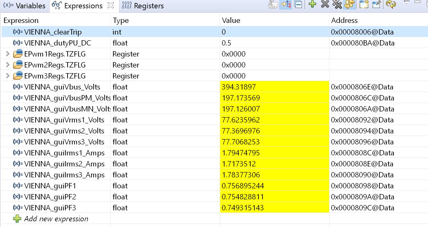

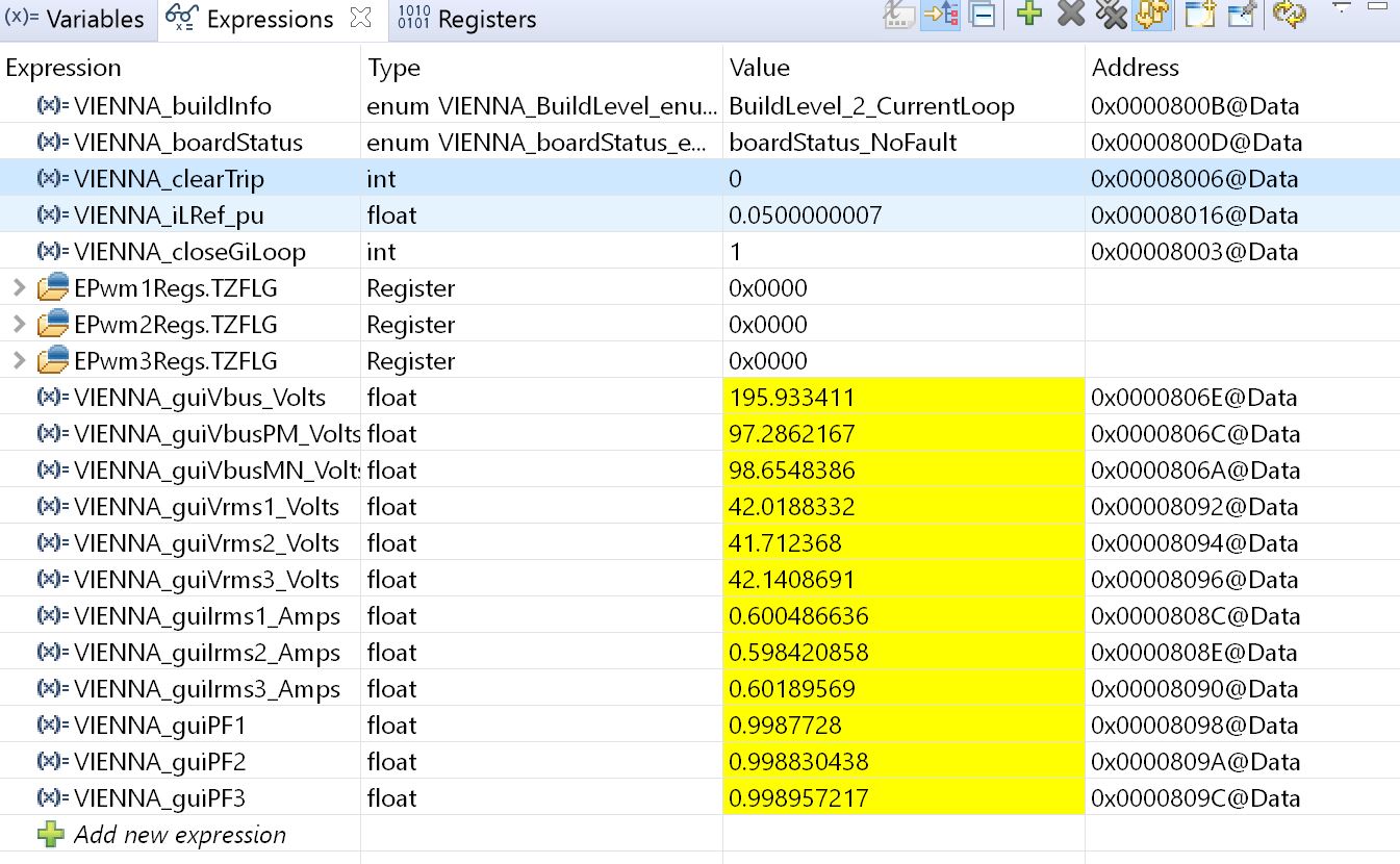

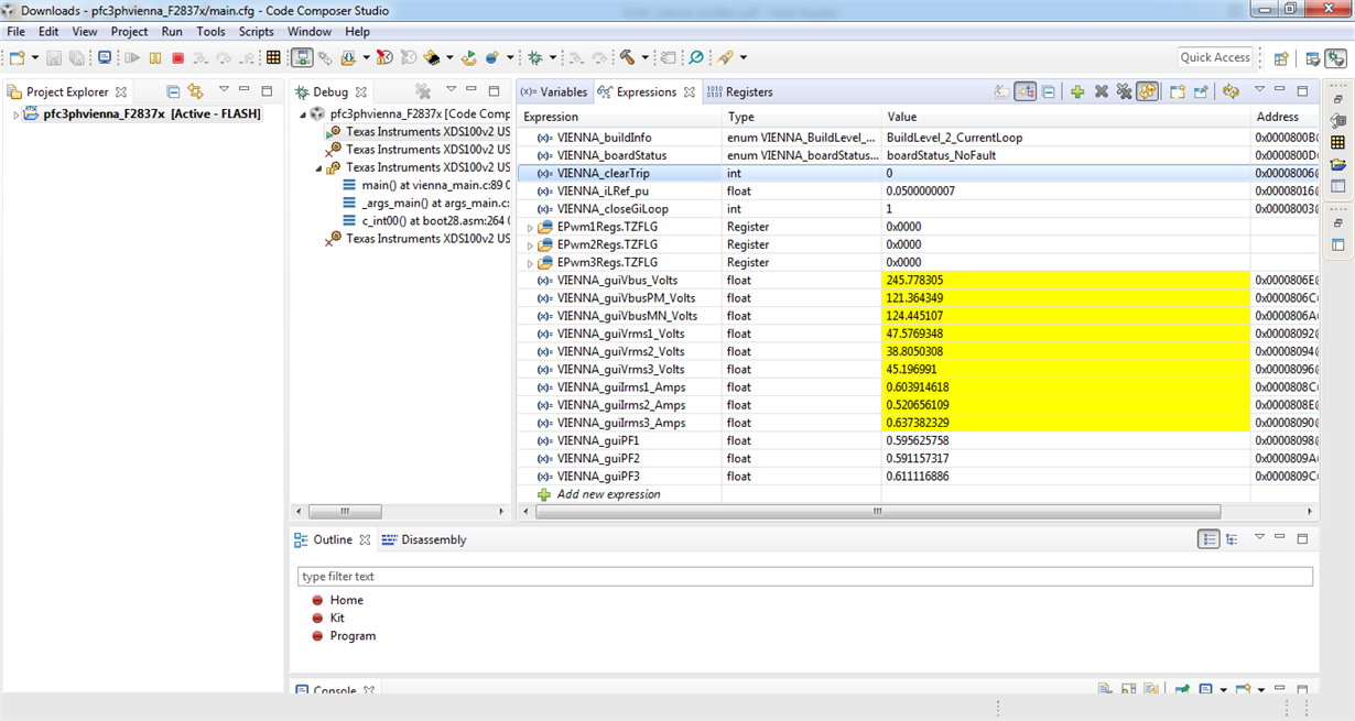

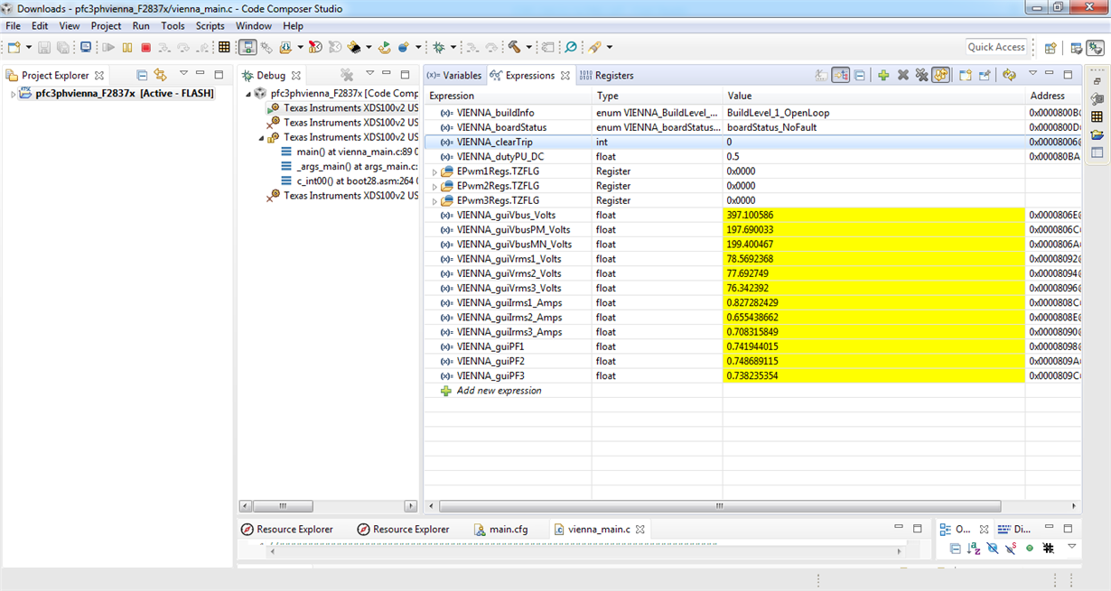

During Build2:Closed Current mode control,We found two abnormalities.
1.PF reading in GUI is showing as 0.83 sometimes 0 which is deviating from other 2lines(PF:0.98)
2.After that we probed the current waveform of all three lines.Line 1 and Line 2have proper sine waveform as mentioned in manual.But Line 3 waveform is not purely sinusoidal and has distortions.
The above results are observed at input 40Vrms(L-N)
Refer the attachment for L3 voltage and current waveform.Blue waveform:Input Current
