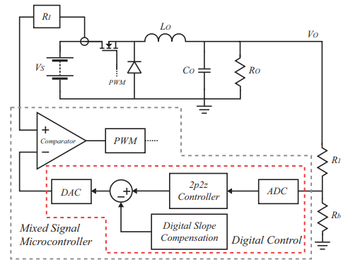

    In response to your vague request of a detailed diagram of what I want, I will implement something similar to the following which is an extract from Microcontroller Based Peak Current Mode Control Using Digital Slope Compensation. The difference with my application is that I'm measuring the inductor current and replacing the diode with a MOSFET.

    The paper mainly focusses on the ramp signal being generated by software instead of RAMP being available in the CMPSS module itself.

    If I understand correctly, I can use the internal DAC of the CMPSS module to generate a rising and falling ramp signal?
  • Tony,
    As I indicated above, the CMPSS DAC has an inbuilt RAMP generator which is only falling. I have recommended to you two methods as work around
    1. Use a rectified current signal such that ramp is only falling.
    2. Or, Write to DAC directly using SW bypassing the internal Ramp, we even have DMA access to CMPSS module which can be used to write the values that the hardware integrated ramp will write.
