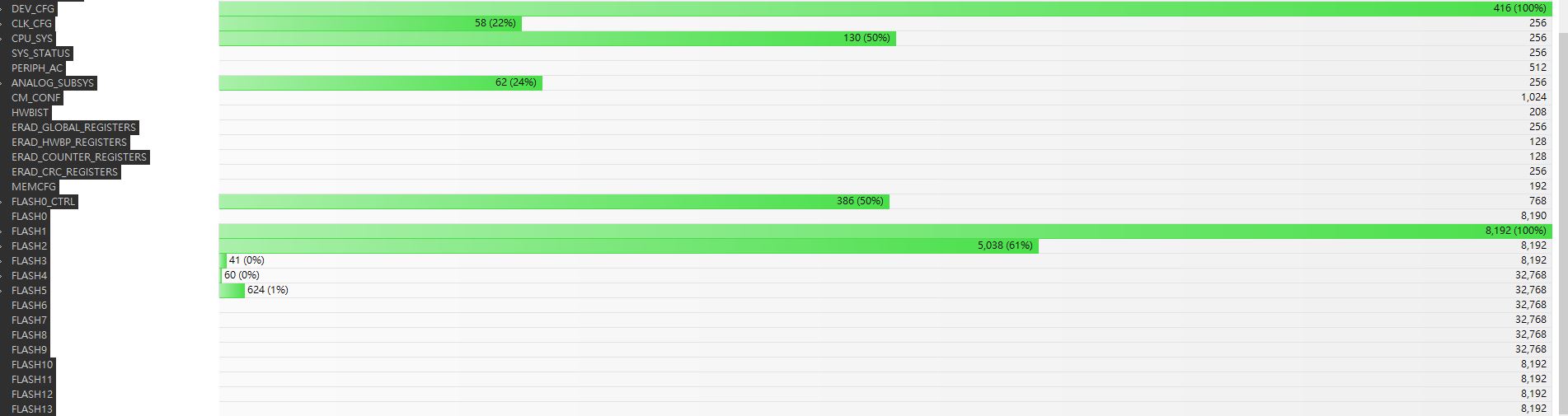

    I have modified 0xD01 as 0xA5 to change to standalone boot mode as follow,
    and I found out that the entry address of flash 0x80000 is 0xFFFFFFFF that meant what I programmed is fail.
    So it turned to USB bootmode
    I have no idea since the other flash section such as 0x82000 is programmed successfully, and I used TI 2838x_flash_lnk_cpu1.cmd file without editing it.

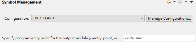

  • I have solved  my problem. I add a symbol "code_start" in properties -> symbol management as below. Even though here comes a warning, CPU could just be booted from flash.
    I wonder why I should add that symbol which is no need in previous dsp such as 28335, 28379,...

    Not sure why you say it wasn't in older devices ?
    The section 2.2 Project Creation of the F2837xD_DEV_USER_GUIDE.pdf that describes the code_start symbol addition.
    The code_start is the first code that is executed after exiting the boot ROM code for the example projects.
    The projects are setup such that the codegen entry point is also set to the codestart label using linker options.
    The codestart code will automatically re-direct the execution to _c_init00.
