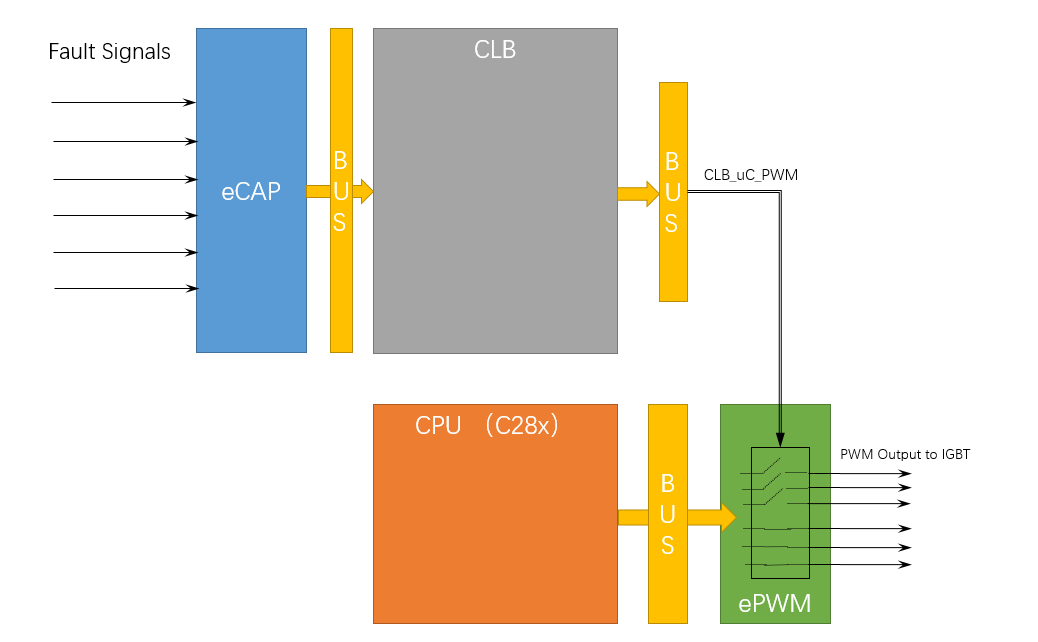

Dear All,
In the TRM,  some description about output of CLB as follow:
(1) PWMA[OE] and PWMB[OE] refer to trip outputs from the respective PWM module.
(2) PWMA[AQ] and PWMB[AQ] refer to the output of the AQ submodule in the respective PWM module.
(3) PWMA[DB] and PWMB[DB] refer to the output of the DB submodule in the respective PWM module.
but I can't find any information about CLB in ePWM chapter, and these descriptions is to simple.  I want to kown the PWMB[OE]/PWMB[AQ]/ mean what?  And which register of AQ/DB  can be directly intervened by CLB.
I can briefly introduce our application background discribed as follow fugure: the CLB moudle is applied to the motor controller. Normally, the C28 core control peripheral (ePWM) sends out PWM signals. In the fault state, CLB needs simple logic to judge the fault type and take over PWM output quickly,so can CLB module realize the above functions through the relationship between output and ePWM module?
