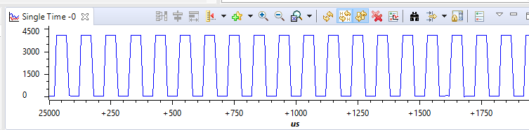

  • Well as I see from the AdcBuf and AdcBuff arrays, only the first element of each reads actual value. From the second element they remain as initial which are zeros.
    *AdcBufPtr++ = 	AdcaResultRegs.ADCRESULT0;			// Read the result
    *AdcBuffPtr++ = AdcaResultRegs.ADCRESULT1;
    The problem is solved. You were right. Actually, EPWM2 was set to trigger ADCSOCA. Then again it was reset and set to generate a PWM signal. The issue is solved. But I am facing another issue. I am now triggering SOC0 and SOC1 to convert ADCINA0 and ADCINA1 respectively with the help of EPWM2SOCA. I have generated EPWM4 signal. While trying to read the same EPWM signal from ADCINA0 and ADCINA1, I noticed that ADCINA0 is swinging full ie. from 0000 to 0FFF. But while trying to read from ADCINA1, it is swinging from 0000 to 0B7D.
    Can you please explain?

  • Please see the figures. The signal from EPWM1A is being read from both ADCA0 and ADCA1, which are triggered by common source EPWM3A. The first one is of ADCINA0 and second figure is of ADCINA1.

  • Hi Sayandev,
    Can you please try out below items:
            - Increase ACQPS to 2x the original value (the value is too low ~60ns SH).
            - If increasing the ACQPS does not provide the full scale value of 0xFFF, can you move A1 connection to another ADC A channel?  Just wanted to see if A1 is being attenuated by something else.
    thanks and regards,
    Joseph
  • Hi Joseph,
    Thank you for your feedback.
    I have done as you said. But now I had following observations:
    1. ADCA0,ADCA1,ADCB0 were triggered from EPWM2SOCA. EPWM1A is being read from the pins. ADCA0 and ADCB0 reads fine. But ADCA1 reads attenuated values.
    2.ADCA0, ADCA1 and ADCA3 are triggered by EPWM2SOCA. EPWM1A is being read from the pins. ADCA0 and ADCA3 reads this.
    while ADCA1 reads
    3. While ADCA3 was given EPWM1A it reads as follows
    but when EPWM1 is read from ADCA1, ADCA3 reads as follows just as I connect pin49 EPWM1 to ADCA1 (pin11).
    I hope you got the problems. Please help. Thank you in advance.
