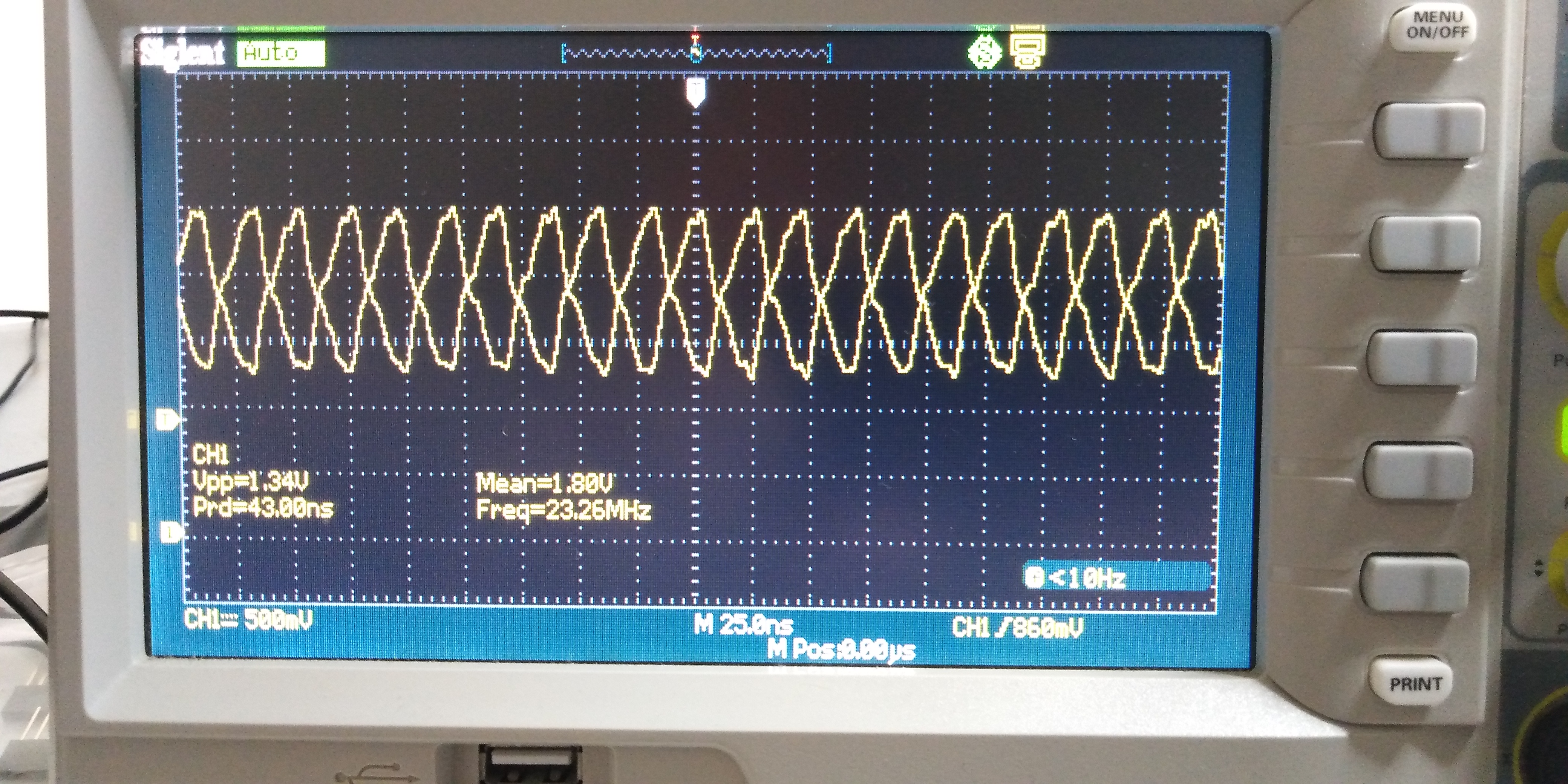

  • Hi Pete,
    Happy new year too!!
    Because of the +/-3% tolerance of the internal oscillator, that note was added taking into account that worse case INTOSC2 frequency would be lower by 3% of the target (10MHz*(0.97)*IMULT/PLLSYSCLKDIV = 194MHz).  Should still be OK to clock using INTOSC2, only that 200MHz cannot be guaranteed because of INTOSC tolerance.
    I tried your exact ASM code that loops writing '1' and '0' to 16 GPIO ports of port A and i'm able to see GPIO transitions of 18.2MHz.  See scope capture below:
    The MOV and branch instructions take up CPU cycles so you would not be able to attain maximum GPIO rate.  If you wanted to attain 25Mhz or higher rate on the GPIO, you can use the CLA instead to update GPIODAT and free up CPU cycles for this task.
    I think you still have an issue with your clock setup.  You might not be configuring CPU1 to run at ~200MHz SYSCLK.  The setup i have configured for the above exercise is using INTOSC2 with a multiplier of 40 and a PLL divider of 1 (div by 2) to produce ~200MHz SYSCLK.
    Joseph

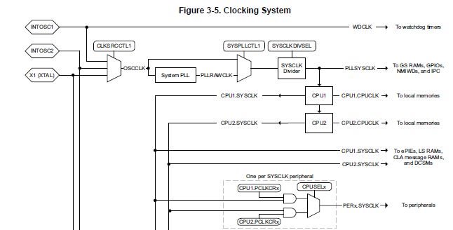

  • Hi Joseph, Thanks for the info. :). I've done what you've said. Changed the clock back to 40 / 2.
    I also read the CLKSRCCTL3 register to see what value PLLRAWCLK equals and it equals 0. What value is it suppose to be?

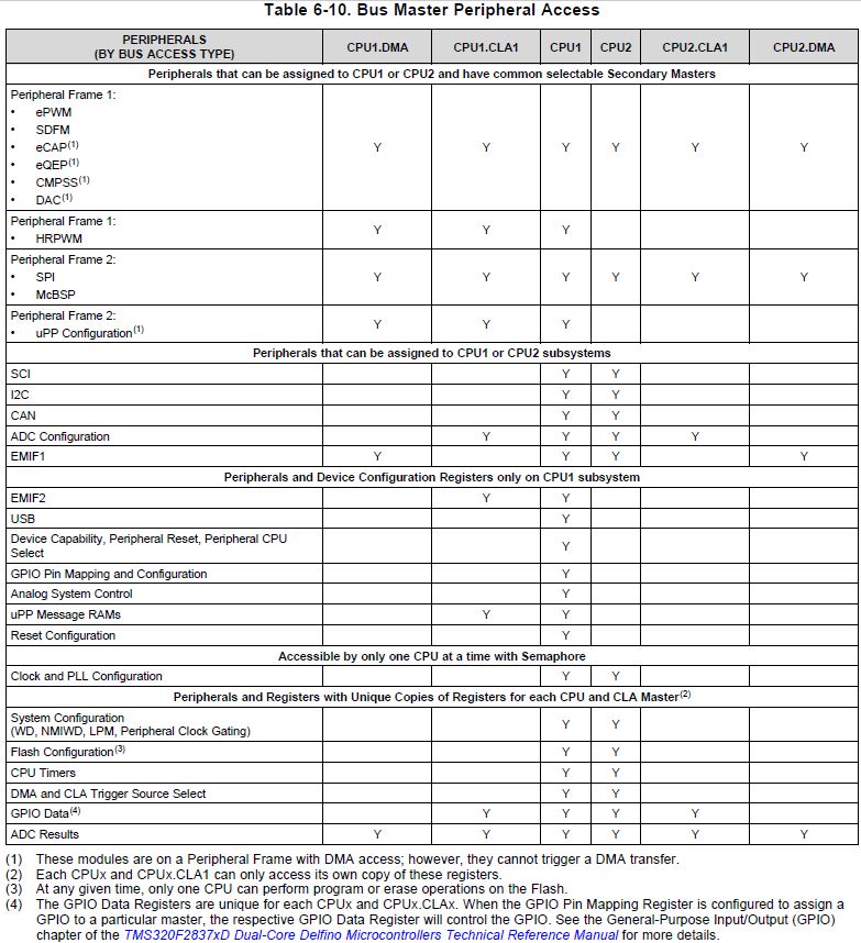

    One more thing, I had an idea that there was another clock running the IO PORTS like the other MCU's we have here but I couldn't find any info about an IO PORTS clock in the TRM.
    Now that you've mentioned that the PLLRAWCLK is used to write to the PORTS I'm thinking thats the clock I've been looking for. At the moment it's probably set with a divider of 40 which kind of makes sense because 200/40 = 5Mhz BUT as usual I could be wrong and your the expert on this.
    I've looked in the TRM and there's only very little info about the PLLRAWCLK. It doesn't say anything about clocking IO PORTS at all. Well I can't find any info.
    Please let me know how to change the PLLRAWCLK to get 25Mhz on my PORTS.
    Thank you so much for your help so far, you would not believe how much I appreciate it. I almost gave up and was going to use another MCU for our product but don't worry, We're sticking with TI.
    Peter
  • Hi Peter,
    You are welcome, and glad to work with you on this issue.
    The IO port transactions are clocked off of the CPU1 clock.  Just to give an idea, let us take a look at the clock tree of the F28377D device (snippet from the TRM):
    What you were probably monitoring is PLLRAWCLK in XCLKOUT as that is the default setting.  PLLRAWCLK probably has not propagated to CPU1 SYSCLK in your case.  Hopefully the diagram helps with your debug, if you want to take that path ... or try to use the PLL code below that I have translated from the C2000Ware C version to assembly.  The ASM code is below:

  • Hi Peter,
    The default XCLKOUT divider is /8, so it seems like things are working correctly.
    Joseph's last post accounts for this:
    I've checked this out and am able to see the correct CPU1 SYSCLK of 200MHz (25*8).
    And a further back post from him is a little more explicit:
    If the PLL is configured correctly, you should measure 25MHz on the XCLKOUT pin with a properly configured 200MHz SYSCLK.

    Just realized DMA does not have access to GPIO Data on F28377D per table below from DS:
    Joseph
  • Hi Joseph, LOL :) Would you believe it ! ok, so DMA is out of the question then.
