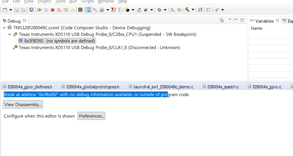

I bought 'C2000™ Piccolo™ F28004x Series LaunchPad™ Development Kit' and i am trying running the TI example code 'launchxl_ex1_f280049c_demo' in FLASH.
I changed cmd file to '28004x_launchpad_demo_flash_lnk.cmd'. and loaded it into FLASH successfully.
after that I pushed resume(F8) button but it didn't run .instead, i got the below message

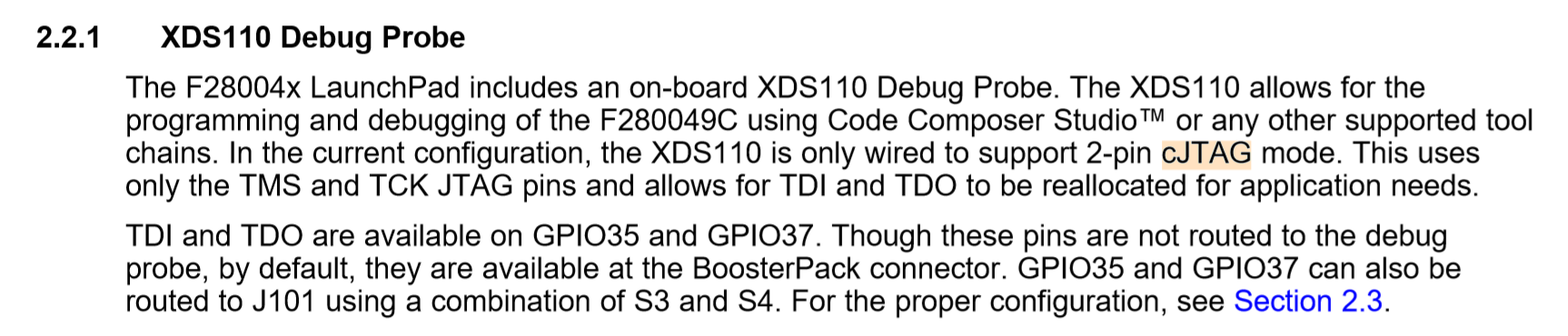

Is that due to the TDI, TDO of JTAG is not routed to the debug probe?
I check the lines below in reference guide
the capture below is the issue i struggled with. after few secs after i pushed the 'Resume' button, this debug window didn't show me anything that proves the code in FLASH run. instead this window popped up with the message.
is there anything that i have to consider and modify?

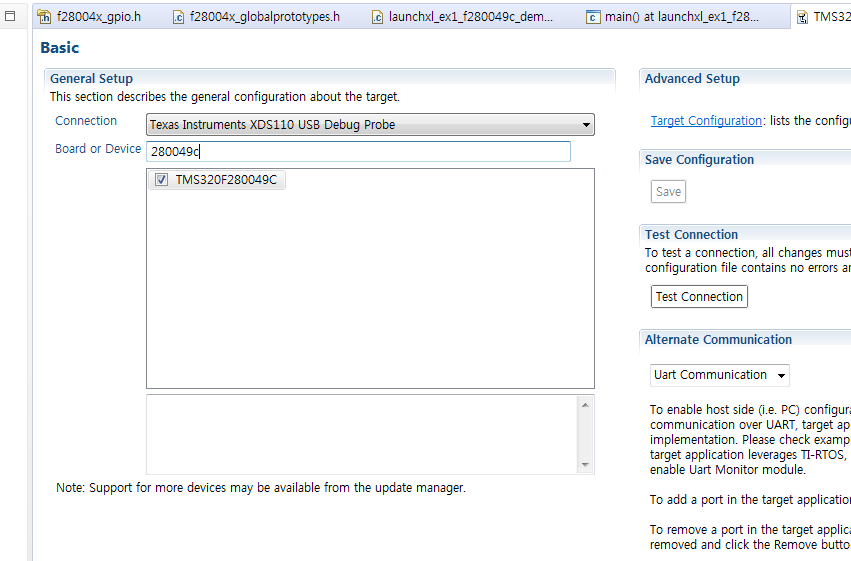

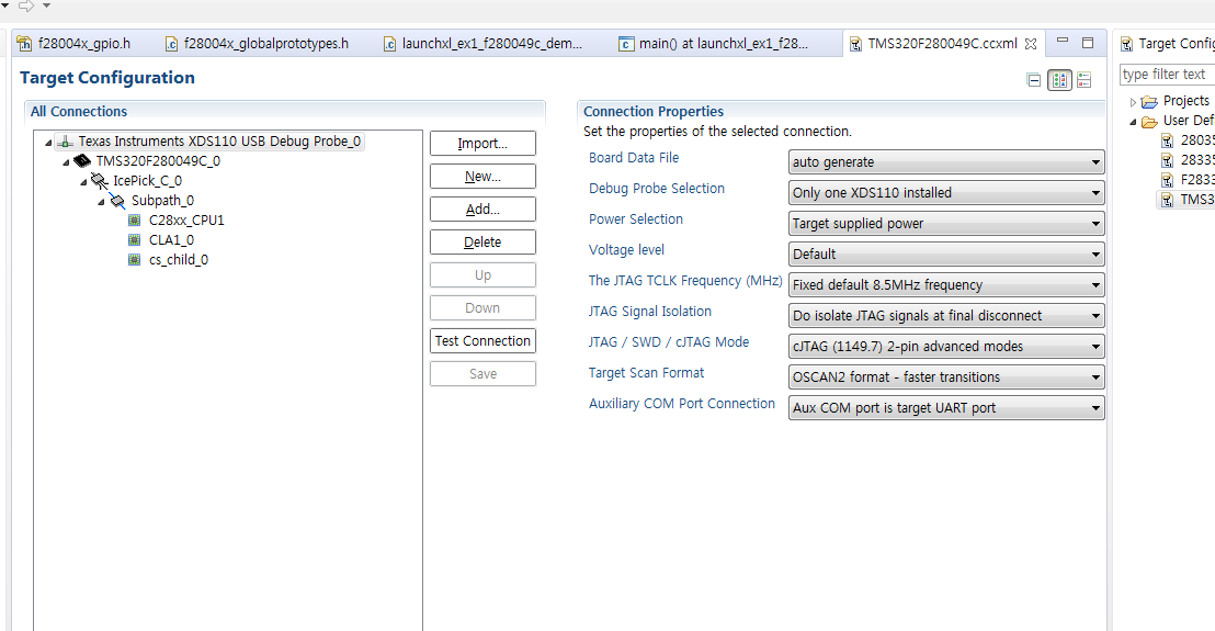

    How have you configured your target config file? Can you provide a screenshot? I assume it's correct since you were able to connect and flash the project, but something still to check.

  • Hey Kevin. thanks for your reply.
    as you request, I am posting several photos that you might need to check.
    the photos below show how I set the target configuration file
    1.
    2.

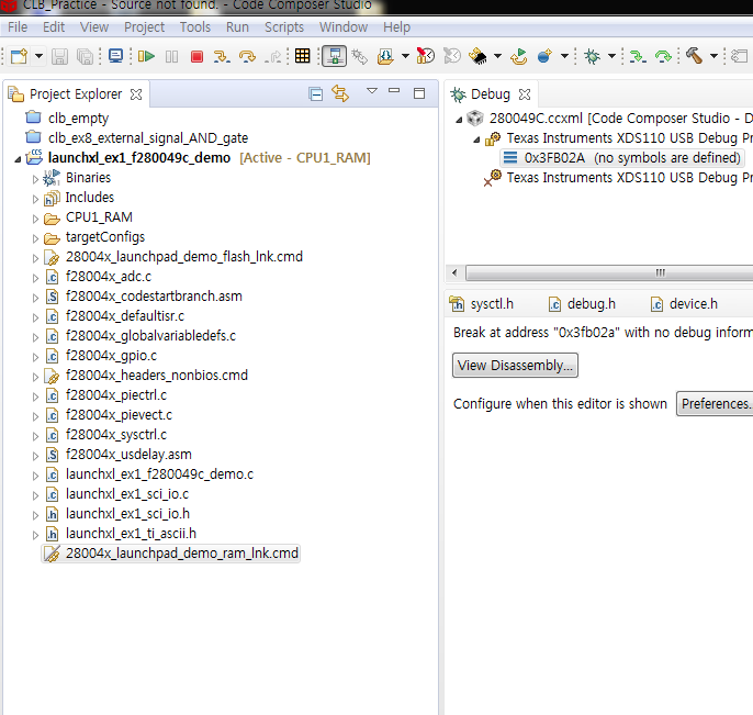

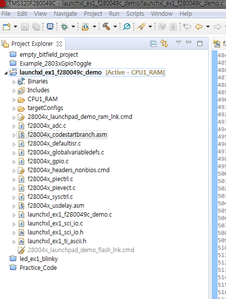

    the photo below shows the file configuration of the project for the app code I try to run from FLASH
    as you can see, 'f28004x_codestartbranch.asm' exists in this project file.
    when I tried running the app code from SARAM It worked well. I could not find any problem.

    What you have shown in your Project Explorer screenshot is the RAM build configuration. Can you show me what is included/excluded when you set the FLASH build configuration. Maybe the .asm file is not included or the wrong linker config file is used when that build config is set?

  • hi Kevin !
    I haven't able to reply on time.. sorry for it
    all I do is just excluding '28004x_launchpad_demo_ram_lnk.cmd' and
    include '28004x_launchpad_demo_flash_lnk.cmd' as same as when I do with F28035 DSP.
    loading to FLASH  of this Launchpad seems to work well but whenever I click the Resume(F8) after finishing loading,
    the app code loaded into FLASH  doesn't run on CCS window. I guess I should set up something about cJTAG but I don't know how ...
    the photo below is what I have with CMD file aforementioned.

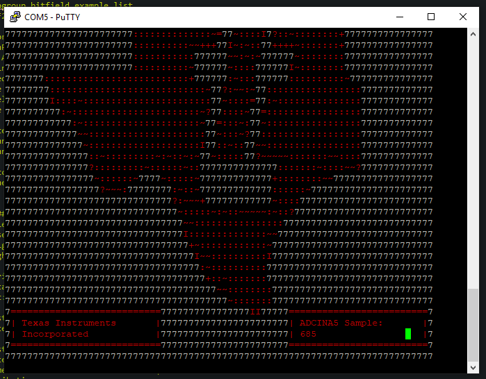

    Are you sure the example program isn't working properly? Have you tried connecting to a serial terminal using the correct COM port and configuration in the example program comments?
    You should see something similar to the below (Used PuttY):
    Kevin

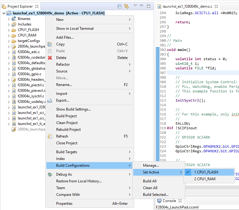

  • Hi Yoonseok,
    Thank you for providing the video, I found what you're issue is. You need to add _FLASH into your Predefined symbols. See my properties image below for this.
    Alternatively, you could right click your project and set the build configuration to CPU1_FLASH, which is configured to run from flash with this define included.
    Kevin

    I am just curious why It is able to run from FLASH by just adding the '_FLASH' symbol in the box of the 'Predefined symbols' section.
  • Hi Yoonseok,
    There are some portions of code for copying code from Flash to RAM that check if _FLASH is defined within the project. This is needed when running a project standalone.
