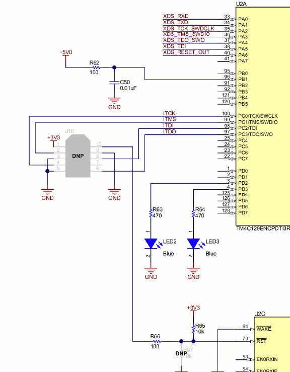

I am using TMS320F280049C launchpad. My 2 board has corrupted firmware of JTAG.
If my Firmware is corrupted and I can flash it in after going in DFU Mode. It is possible if I am able to find my JTAG device in DFU mode. I did it sometimes.
But in now I am unable to detect Launchpad in my machine(Not in device manager). Hence I am unable to load firmware using XDSDFU utility.
What should I do next to solve this problem?

    I performed the above steps but couldn't resurrect LP.  After forcing it into DFU by connecting TDO to the ground, my LP is not detected by the machine.
    I have one more question, When I force the processor in DFU mode, I have an only USB connection to upload the bootloader. Is the processor is able to accept firmware by USB or it accepts through only JTAG. LP has a separate JTAG connector for the TIVA ARM processor.
  • Chirag,
    It should accept programmation through the USB, can you confirm that you are connecting pad 6 of J10(on the back of the board) to ground.  This is TDO of of the TIVA device.
    I'm going to request some folks from our emulation team take a look at this thread to see if there is another way to get the TIVA back to behaving as an XDS110 that I may be missing.
    Matthew
  • Is it possible the DAP is locked out and the unlocking procedure is require? Can the DAP port be unlocked in CCS debug via XDS110 console as we can do for TM4C1294 MCU?
    If the Debug Probe can't be seen by the host, even after trying to run its ROM bootloader by shorting Pin 97 to GND, there is a very strong possibility the TM4C129 device or one of its surrounding circuits are damaged (xtal, power, etc.).
    To be absolutely certain, you would need the pogo adapter to plug into J10 (under the board) and an external Debug Probe to try and observe the TM4C129 device status.
    One question is: why exactly the firmware was becoming corrupt? Are there any surrounding conditions that could be causing this such as ground loops, faulty USB ports or cables, power issues caused by external factors (plug-in boards or other accessories)?
    If any external system is tied to the board, I would start fully isolating the USB port by removing the jumpers JP1/2/3 and provide external power.
    If there are no external systems, I would focus on the connection between the board and the host.

  • Hii,
    Jumper 10 on Launchpad has a different connection pattern than a normal 10 pin ARM JTAG connection. That means I can't directly use output of XDS110 10 pin connector output(need to change connection pattern). Am I right?
    I am attaching both images.
  • It looks like the JTAG header picture was taken from the bottom PCB layer, is only inverted. Typically you need to make sure XDS110 pin 1 red stripe is aligns to pin 1 of launch pad header. Pin 1 should be marked on the PCB and external JTAG often requires you to remove a resistor or pull specific ICDI input low for the JTAG header to pass into the target MCU and ICDI port enters high impedance state to target.
    I seriously doubt the external JTAG results will be any different and you should first attempt the unlocking procedure from CCS debug. You first have to modify the projects debug properties to Not load the program into flash, causing an abort exception fault. That way the DAP typically will accept a connection via ICDI direct from CCS debug and you attempt to use the console procedure for unlocking the device.
