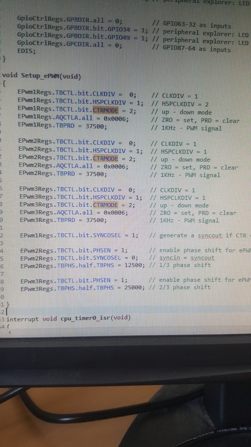

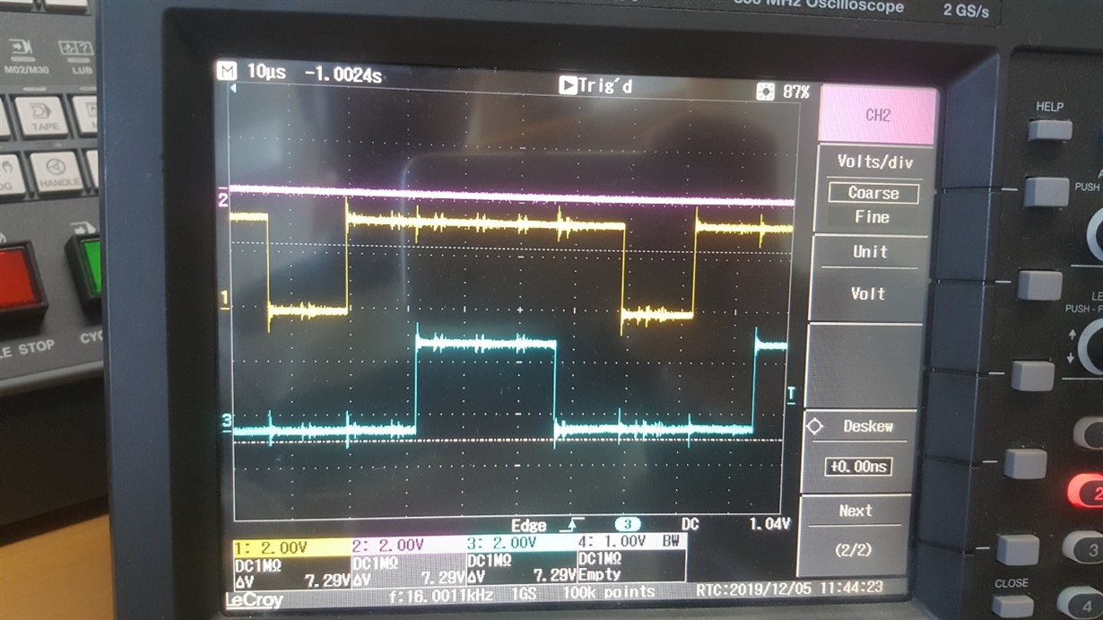

I am working on the workshop example that is given by TI.
I have compiled the code for epwm generation for three-phase but :
1) with changing TBPRD value nothing change across epwm output but for the same code and register values one of the epwm output has different duty cycle than other 2 (as shown in fig)
2) when I add the phase shift and debug the code again the result across epwm output is the same as before without the shift it seems that shift is not working.
I want to know about these two and I also attached the pic for proper descript of the issue

  • thanks for the response.
    I am using header file from c2000ware and compiler version Tl18.12.2 LTS with ccs9.0
    I have a double match with the solution file but the problem is still there and I also check to try with a single and three-phase epwm signal with the same TBPRD(for 1KH)  PWM Freq.
    and the second thing I want to know that when I backspace(mean remove or exclude from the debug) all the code for epwm2 and epwm3 and run the file with just epwm1  at output I can see the three epwm(epwm1,epwm2,epwm3) signal. Please guide me what the problem or issue that this happening.
    Is anything wrong that with the code

  • here is the code that i used:
    i am using customized board designed by my employer and thats working absolutely well so i am checking the pwm signal across gpio(0,2,4)

    void Gpio_select(void)
     EALLOW;
     GpioCtrlRegs.GPAMUX1.all = 0;  // GPIO15 ... GPIO0 = General Puropse I/O
     GpioCtrlRegs.GPAMUX1.bit.GPIO0 = 1; // ePWM1A active
     GpioCtrlRegs.GPAMUX1.bit.GPIO2 = 1; // ePWM2A active
     GpioCtrlRegs.GPAMUX1.bit.GPIO4 = 1; // ePWM3A active
     GpioCtrlRegs.GPAMUX2.all = 0;  // GPIO31 ... GPIO16 = General Purpose I/O
     GpioCtrlRegs.GPBMUX1.all = 0;  // GPIO47 ... GPIO32 = General Purpose I/O
     GpioCtrlRegs.GPBMUX2.all = 0;  // GPIO63 ... GPIO48 = General Purpose I/O
     GpioCtrlRegs.GPCMUX1.all = 0;  // GPIO79 ... GPIO64 = General Purpose I/O
     GpioCtrlRegs.GPCMUX2.all = 0;  // GPIO87 ... GPIO80 = General Purpose I/O
     GpioCtrlRegs.GPADIR.all = 0;
     GpioCtrlRegs.GPADIR.bit.GPIO9 = 1; // peripheral explorer: LED LD1 at GPIO9
     GpioCtrlRegs.GPADIR.bit.GPIO11 = 1; // peripheral explorer: LED LD2 at GPIO11
     GpioCtrlRegs.GPBDIR.all = 0;  // GPIO63-32 as inputs
     GpioCtrlRegs.GPBDIR.bit.GPIO34 = 1; // peripheral explorer: LED LD3 at GPIO34
     GpioCtrlRegs.GPBDIR.bit.GPIO49 = 1; // peripheral explorer: LED LD4 at GPIO49
     GpioCtrlRegs.GPCDIR.all = 0;  // GPIO87-64 as inputs
     EDIS;
    void Setup_ePWM(void)
     EPwm1Regs.TBCTL.bit.CLKDIV =  0; // CLKDIV = 1
     EPwm1Regs.TBCTL.bit.HSPCLKDIV = 1; // HSPCLKDIV = 2
     EPwm1Regs.TBCTL.bit.CTRMODE = 2; // up - down mode
     EPwm1Regs.AQCTLA.all = 0x0006;  // ZRO = set, PRD = clear
     EPwm1Regs.TBPRD = 37500;   // 1KHz - PWM signal
     EPwm2Regs.TBCTL.bit.CLKDIV =  0; // CLKDIV = 1
     EPwm2Regs.TBCTL.bit.HSPCLKDIV = 1; // HSPCLKDIV = 1
     EPwm2Regs.TBCTL.bit.CTRMODE = 2; // up - down mode
     EPwm2Regs.AQCTLA.all = 0x0006;  // ZRO = set, PRD = clear
     EPwm2Regs.TBPRD = 37500;   // 1KHz - PWM signal
     EPwm3Regs.TBCTL.bit.CLKDIV =  0; // CLKDIV = 1
     EPwm3Regs.TBCTL.bit.HSPCLKDIV = 1; // HSPCLKDIV = 1
     EPwm3Regs.TBCTL.bit.CTRMODE = 2; // up - down mode
     EPwm3Regs.AQCTLA.all = 0x0006;  // ZRO = set, PRD = clear
     EPwm3Regs.TBPRD = 37500;   // 1KHz - PWM signal
     EPwm1Regs.TBCTL.bit.SYNCOSEL = 1; // generate a syncout if CTR = 0
     EPwm2Regs.TBCTL.bit.PHSEN = 1;  // enable phase shift for ePWM2
     EPwm2Regs.TBCTL.bit.SYNCOSEL = 0; // syncin = syncout
     EPwm2Regs.TBPHS.half.TBPHS = 12500; // 1/3 phase shift
     EPwm3Regs.TBCTL.bit.PHSEN = 1;  // enable phase shift for ePWM3
     EPwm3Regs.TBPHS.half.TBPHS = 25000; // 2/3 phase shift

  • Muhammad,
    I have compared your code to the solutions file and it is almost exact, except you commented out servicing the watchdog with 0x55 and 0xAA.  However, at the top of main() you still have code to enable the watchdog (which was most likely disabled in CodeStartBranch.asm).  Did the solution file run "as is" on your target?  Do you have an F28335 Experimenter's Kit or Explorer Kit at the university that you can try the code on?  This would help determine if the issue is your target board or software.
    Still, at this point you are not generating the PWM waveform as configured in the code.  I suggest making the source file as simple as possible and then running a test.  Since the only purpose of this program is to configure the ePWM module - remove or comment out everything else.  That is, disable the watchdog and only keep the code to configure the three GPIO pins (ePWM1A/2A/3A), the ePWM setup function, and use a NOP in the while loop (see workshop for example).  Do not include the CPU Timer function and GPIO toggling in the while loop.  Note that this test does not require the use of interrupts, so that does not need to be configured.  All we are trying to do is just generate the waveforms.  So in summary, you will need InitSysCtrl() function, code to configure the three GPIO pins (EALLOW protected) and the code to configure the ePWM modules.  Run this test and see if the correct waveforms are being generated.

  • unfortunetly at this time i don't have experimental kit to try this code justhave this customized baord to try with...
    i follow instruction and make the code as simple as u suggst but the output result are same and one more thing i tried to check with just 1 epwmA active and debug the code and i find tht across gpio0 gpio 2 gpio 4 i am still getting the output as the gpio2 and gpio4 are disable from the code .....
    an when i disable the watchdog at start then there no output across gpio0,2,4 so thats why i enable the whatcdog at top of main: .WDCR=0x00AF..

  • Muhammad,
    What you are experiencing does not follow the coding in your previous reply.  When the watchdog is disabled there should be no effect on the ePWM outputs and when only one output is selected you should not see a signal on the other outputs.  Check your project and make sure that there are no other files changing the registers.  Also, power-down your target to see if that helps.
    Please try the attached file and let me know if this works.
    - Ken
    /cfs-file/__key/communityserver-discussions-components-files/171/Lab7_5F00_2_2D00_EpwmOnly.c
  • Thanks Ken,
    with disable the watchdog the system run and the output across the pwm pin is exact as we need
    This solved my issue
