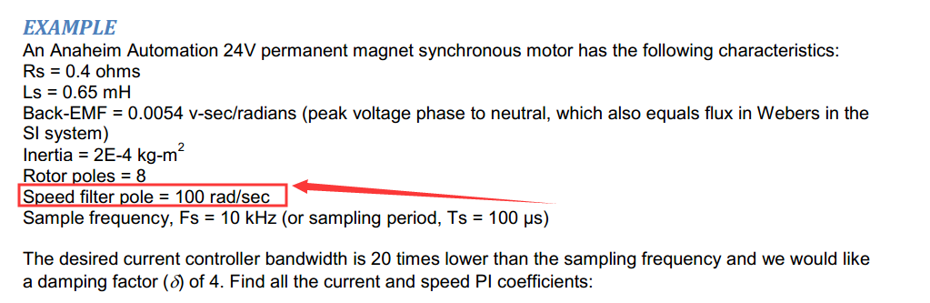

2.I found that the speed filter pole is 100 rad/s in the lab05b guide,but I have not found it in lab05b program.
So I want to know all the speed filter pole default value is 100rad/s? and where I can find it in lab05b program?
Because I want to use my motor parameter to simulation and compare the simulation step response curve and the motor actual step response curve.
    So I want to know all the speed filter pole default value is 100rad/s in InstaSPIN ? and where I can find it in lab05b program?
    Because I want to use this parameter to simulation.
