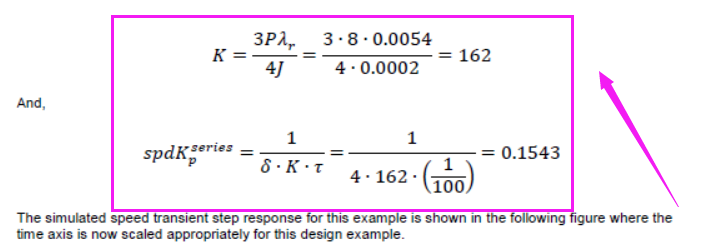

but I find that the inertia value  unit  identify by lab12a  is A / Krpm/s.
the inertia SI unit is Kg * m^2.
1.So how to change the inertia value from A / Krpm/s to the SI unit  Kg * m^2.

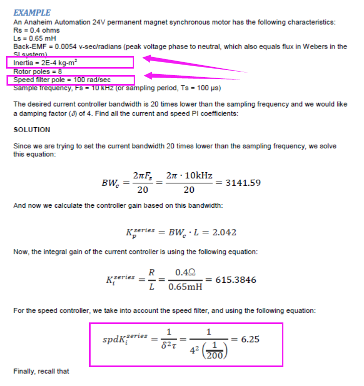

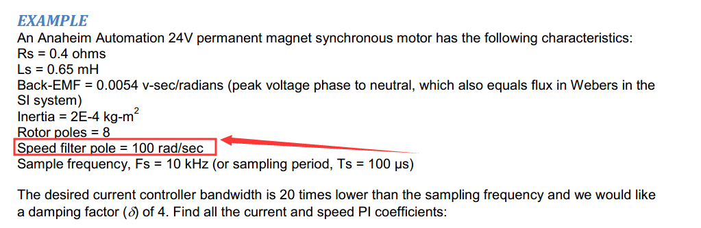

2.I found that the speed filter pole is 100 rad/s in the lab05b guide,but I have not found it in lab05b program.
So I want to know all the speed filter pole default value is 100rad/s? and where I can find it in lab05b program?

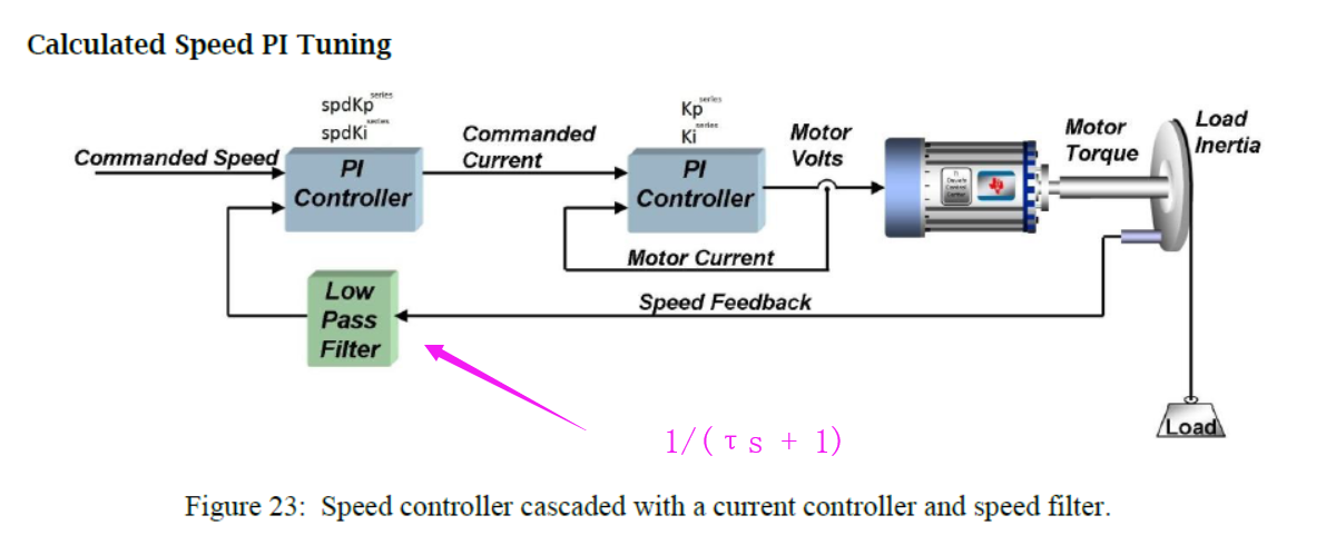

    I think the speed filter  is just a LPF. and the LPF pole is equal to 1/τ.
    The lab05b has used the speed filter pole and the Inertia J to calculate the speed PID .just as fellow in <lab user guide>
    Although the calculation speed pid method  has not implement in lab05b program.
    and I just want to use the  speed filter pole parameter to  simulation the system in MATLAB.
    So  the  speed filter pole parameter is necessary.
    Please give me a help.
