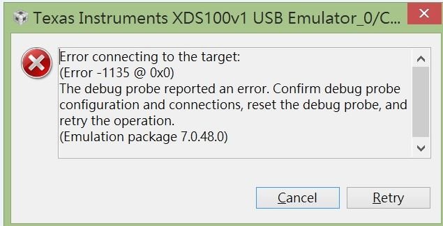

I have a “C2000 2 Phase Interleaved Power Factor Correction Kit” with “Piccolo F28035 Isolated controlCard”. According to the TIDU249 (ILPFC, http://www.ti.com/lit/ug/tidu249/tidu249.pdf), I want to compiler the project (C:\ti\controlSUITE\development_kits\ILPFC_v1.3) to a ram mode for debugging. So,

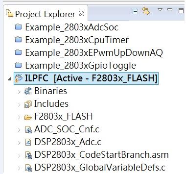

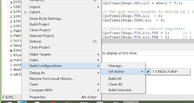

1. how can I change from F2803x_FLASH mode to F2803x_RAM mode ?
2. There is an error while I going to debug mode. How can I resolve the problem ?

    Right click on the project name in the explorer window you have shown above.  About 3/4 of the way down the new dialog box you should see a selection called "Build Configurations" hover over this and then pick "Set Active" and you should see an option for RAM build.  After picking this, rebuild the project, and the entire program should load to SRAM.
    For the debugging question, I recommend launching the debug session manually vs via the CCS "Debug" button. To do this:
    1)Right click on your target ccxml in the Target Configurations window.  Select "Launch Target Configuration"
    2)This should open the debug perspective, if not please let me know.  Otherwise, you should observe the C28x CPU listed under the emulation connection.  RIght click on this and select "Connect Target"
    3)At this point if you are connected you can attempt to load code from your project(either RAM or flash)
    Let me know if any of the above steps fail and we can debug more.
    Matthew
  • Dear Matthew,
    Q1: I still can not select the RAM mode according your instructuion. Because there is no RAM to select.

  • Hung-Jin,
    I looked at this example specifcally and it looks like it was not created with a RAM only build option.  I haven't looked at the code size, but you could see if you can re-direct the flash sections into RAM, but if it is larger than the RAM on the chip this obviously won't work.
    For the connection issue I assume you are using the on-board JTAG chip, via the USB connection.  Note that since this is an isolated config only the JTAG circuit is being powered from that USB connection.  You will still need to supply power to the MCU/main board from the docking station/DIMM connection.  Can you confirm both sides of the iso boundary are powered?
    Matthew

  • Hugh-Jin,
    Let me clarify a bit:
    1)2Ph IL PFC Board will need 12V connection at barrel jack, which will give 5V/3.3V output; 5V will get routed through the DIMM to the control CARD to U4 5V->3.3V to power the F28035 MCU
    2)Piccolo F28035 Iso Control Card should have USB Type B mini port labeled J1.  This is routed to a FTDI FT2232D USB to serial CPLD, that is programmed to function as a XDS100v1 debug probe.  However, due to the isolation the 5V from the USB connection does not cross to supply the U4 from above with power.
    So, I want to make sure that both the JTAG debug probe and the MCU have power.
    Matthew

  • Hung-Jin,
    I've attached the InfoSheet, which has some quick start info; let's check this to make sure your setup is the same as mine:
    Specifically let's look at page 2,
    1)When you plug in the USB Type B Mini to the control CARD you should see LED LD4 light up; this indicates that the FTDI/XDS100v1 debug probe has power
    2)When you plug in the 12V to the barrel jack on the bottom board (2Ph IL PFC) and the switch in in the correct posistion you should see LED LD1 light up
    3)Make sure Switch SW3 on the control CARD is "ON" as this enables the TRSTn path to the device
    4)Make sure that the device is in "Wait" Boot mode by putting SW2 as SW2:1 = off and SW2:2 = on.
    Please confirm the above is done and the device still can't connect with CCS.

  • Dear Matthew,
    My EVM already can entry into debug window  after I set the SW2 and SW3 on control CARD as your mention last post.
    Thanks!
    Hung-Jin
