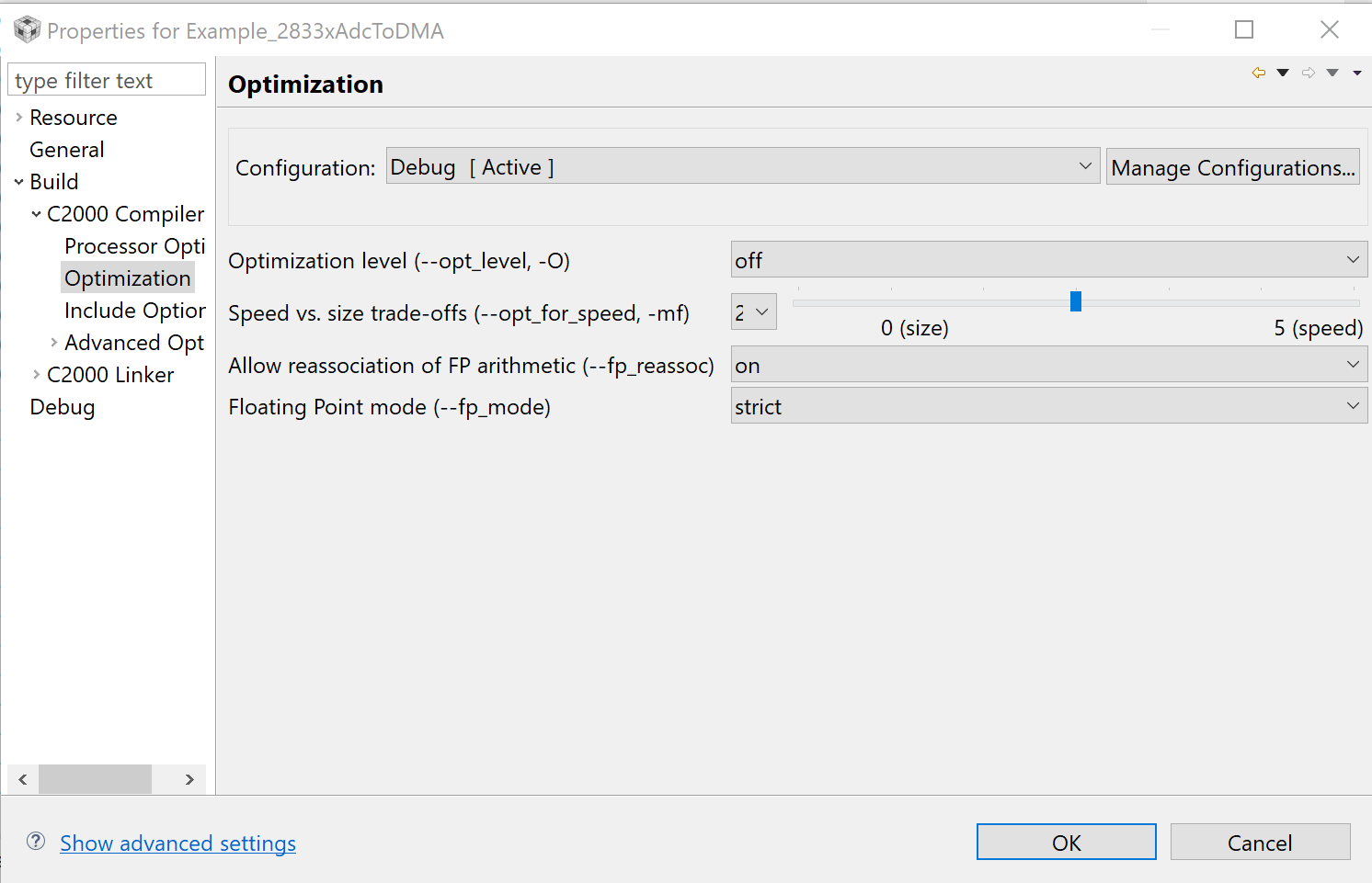

Could you suggest that how to configure the below items to optimize the program running speed while maintaining code integrity?

Hello Rayna,
It is important to understand the impact of each of the compiler optimization levels available.
This FAQ is a good start: https://software-dl.ti.com/ccs/esd/documents/c2000_c28x-code-generation-tips-and-tricks.html#optimization
For more details, I strongly suggest reading chapter 3 of the Compiler user's guide:
http://dev.ti.com/tirex/explore/node?node=APrU60ITeJcy-f1L4BfYJA__FUz-xrs__LATEST
Also please be aware of the tradeoff between optimization and debug visibility:
http://dev.ti.com/tirex/explore/node?node=AA6fEd9YTSwdDSyHdoLE9Q__FUz-xrs__LATEST
