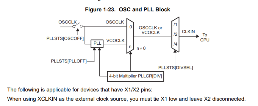

TMS320F28069: What is the formula to calculate System clock frequency from external Oscillator input. Formula is mentioned in the supporting document. also confusion between 4-bit multiplier PLLCR[DIV]
Part Number: TMS320F28069
  • Sachin,
    SYSCLKOUT = (OSCCLK * PLLCR[DIV] / PLLSTS[DIVSEL])
    Where SYSCLKOUT = operating frequency of the device, OSCCCLK = frequency of the i/p clock to the device, PLLCR[DIV] = PLL multiplier value & PLLSTS[DIVSEL] = clock divider at the o/p of the PLL.
