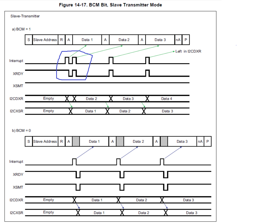

  • Hi Kevin,
    Another question related to the BCM bit here. When BCM set to 1, will the situation in blue cycle 100% happen?
    Take PMBus as an example, enable AAS, SCD, XRDY and RRDY interrupt, when master read the slave, will the slave generated two XRDY in 100% as shown in the blue cycle? We need this for when only one XRDY is generated, underflow happens and SCL be pulled low.

  • Hi Kevin,
    Sorry for forgetting the graph here.
    My customer cares about this because they enabled mulitple interrupt. So of them may confilit the first interrupt in the blue cycle and cause error in their software logic. Could you help me confirm that when these four interrupts I mentioned are enabled, the two interrupt in the blue cycle can be guaranteened?

  • Hi Sheldon,
    Yes, if BC is set to 1 and the device is configured as a slave transmitter, then the XRDY state and interrupt will match what is shown in the figure.
