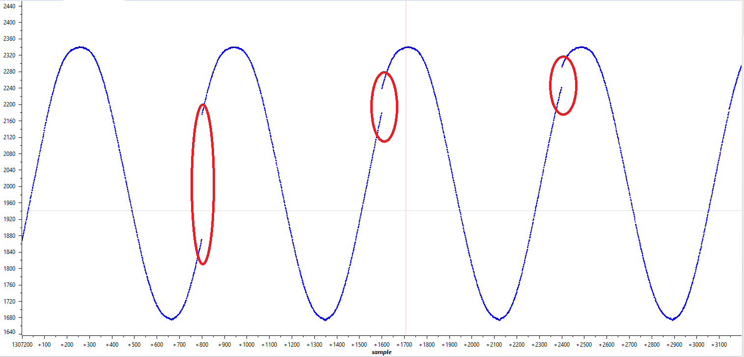

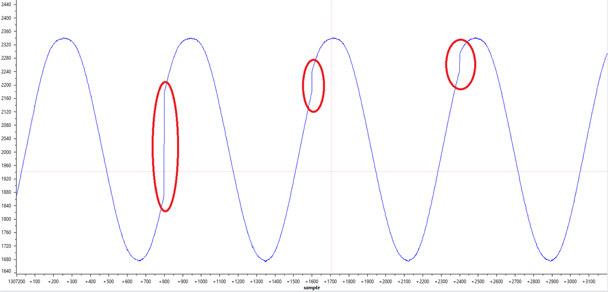

CCS/TMS320F28335: Sine signal reading problem.
Part Number: TMS320F28335
Dear Sir/Madam,
I am using TMSDOCKF28335 hardware with control card. I am giving sine signal from outside with 50Hz through signal conditioner shifted by 1.5V and range is between 0 to 3V. Here I am collecting samples through epwm trigger. Epwm1 is running with the frequency of 40kHz according to that I have to get 800 samples to construct complete sine signal. I am able to log 800 samples but there is one glitch is repeating for every 800 sample I need pure sine waveform. But I am unable get the desired signal. Because of this problem my SPLL is getting worse for every few cycles of sine wave. Here I am attaching the code I used and also Linker command file along with the waveforms.Please suggest something.

#include "DSP28x_Project.h"     // Device Headerfile and Examples Include File
// Function Prototypes
__interrupt void adc_isr(void);
// Globals
Uint16 LoopCount;
Uint16 ConversionCount;
Uint16 VG[800];
// Main
void main(void)
    // Step 1. Initialize System Control:
    // PLL, WatchDog, enable Peripheral Clocks
    // This example function is found in the DSP2833x_SysCtrl.c file.
    InitSysCtrl();
    EALLOW;
    #if (CPU_FRQ_150MHZ)     // Default - 150 MHz SYSCLKOUT
        // HSPCLK = SYSCLKOUT/2*ADC_MODCLK2 = 150/(2*3)   = 25.0 MHz
        #define ADC_MODCLK 0x3
    #endif
    #if (CPU_FRQ_100MHZ)
        // HSPCLK = SYSCLKOUT/2*ADC_MODCLK2 = 100/(2*2)   = 25.0 MHz
        #define ADC_MODCLK 0x2
    #endif
    EDIS;
    // Define ADCCLK clock frequency ( less than or equal to 25 MHz )
    // Assuming InitSysCtrl() has set SYSCLKOUT to 150 MHz
    EALLOW;
    SysCtrlRegs.HISPCP.all = ADC_MODCLK;
    EDIS;
    // Step 2. Initialize GPIO:
    // This example function is found in the DSP2833x_Gpio.c file and
    // illustrates how to set the GPIO to it's default state.
    // InitGpio();  // Skipped for this example
    // Step 3. Clear all interrupts and initialize PIE vector table:
    // Disable CPU interrupts
    DINT;
    // Initialize the PIE control registers to their default state.
    // The default state is all PIE interrupts disabled and flags
    // are cleared.
    // This function is found in the DSP2833x_PieCtrl.c file.
    InitPieCtrl();
    // Disable CPU interrupts and clear all CPU interrupt flags:
    IER = 0x0000;
    IFR = 0x0000;
    // Initialize the PIE vector table with pointers to the shell Interrupt
    // Service Routines (ISR).
    // This will populate the entire table, even if the interrupt
    // is not used in this example.  This is useful for debug purposes.
    // The shell ISR routines are found in DSP2833x_DefaultIsr.c.
    // This function is found in DSP2833x_PieVect.c.
    InitPieVectTable();
    // Interrupts that are used in this example are re-mapped to
    // ISR functions found within this file.
    EALLOW;  // This is needed to write to EALLOW protected register
    PieVectTable.ADCINT = &adc_isr;
    EDIS;    // This is needed to disable write to EALLOW protected registers
    // Step 4. Initialize all the Device Peripherals:
    // This function is found in DSP2833x_InitPeripherals.c
    // InitPeripherals(); // Not required for this example
    InitAdc();  // For this example, init the ADC
    // Step 5. User specific code, enable interrupts:
    // Enable ADCINT in PIE
    PieCtrlRegs.PIEIER1.bit.INTx6 = 1;
    IER |= M_INT1;      // Enable CPU Interrupt 1
    EINT;               // Enable Global interrupt INTM
    ERTM;               // Enable Global realtime interrupt DBGM
    LoopCount = 0;
    ConversionCount = 0;
    // Configure ADC
    AdcRegs.ADCMAXCONV.all = 0x0000;       // Setup 2 conv's on SEQ1
    AdcRegs.ADCCHSELSEQ1.bit.CONV00 = 0x2; // Setup ADCINA3 as 1st SEQ1 conv.
    // Enable SOCA from ePWM to start SEQ1
    AdcRegs.ADCTRL2.bit.EPWM_SOCA_SEQ1 = 1;
    AdcRegs.ADCTRL2.bit.INT_ENA_SEQ1 = 1;  // Enable SEQ1 interrupt (every EOS)
    // Assumes ePWM1 clock is already enabled in InitSysCtrl();
    EPwm1Regs.ETSEL.bit.SOCAEN = 1;     // Enable SOC on A group
    EPwm1Regs.ETSEL.bit.SOCASEL = 4;    // Select SOC from from CPMA on upcount
    EPwm1Regs.ETPS.bit.SOCAPRD = 1;     // Generate pulse on 1st event
    EPwm1Regs.CMPA.half.CMPA = 1875;	// Set compare A value
    EPwm1Regs.TBPRD = 3750;           // Set period for ePWM1
    EPwm1Regs.TBCTL.bit.CTRMODE = 0;	// count up and start
    EPwm1Regs.TBCTL.bit.HSPCLKDIV=0;
    EPwm1Regs.TBCTL.bit.CLKDIV=0;
    // Wait for ADC interrupt
    for(;;)
        LoopCount++;
// adc_isr -
__interrupt void
adc_isr(void)
    VG[ConversionCount] = AdcRegs.ADCRESULT0 >>4;
    // If 40 conversions have been logged, start over
    if(ConversionCount == 800)
    else
        ConversionCount++;
    // Reinitialize for next ADC sequence
    AdcRegs.ADCTRL2.bit.RST_SEQ1 = 1;         // Reset SEQ1
    AdcRegs.ADCST.bit.INT_SEQ1_CLR = 1;       // Clear INT SEQ1 bit
    PieCtrlRegs.PIEACK.all = PIEACK_GROUP1;   // Acknowledge interrupt to PIE
    return;

  • What you have shown is happening at every 800 sample, that means you have a logging issue, I am not sure if you only log for 800 cycles how can you plot 3000+ samples on the graph?
    I am unable to debug customer code. Sorry, I can only offfer some generic info.
  • Dear Sir,
    Since Epwm1 is running at 40kHz I am getting 800 samples to log complete 50Hz power cycle. while plotting graph in code composer buffer size I am keeping 800 samples only and display size I am keeping 4*800 samples to view 4 complete cycles. While I am plotting more cycles I am able see this marked portion is moving with respect to time. Because of this I am facing SPLL synchronization problem.  Am I written correct for logging the data for a 50 Hz wave using Epwm or I am doing the calculation for number of samples is wrong. Please suggest something in this regard. Please find the code attached for your reference.
        AdcRegs.ADCTRL3.bit.SMODE_SEL=0;
        AdcRegs.ADCMAXCONV.all = 0x00020       // Setup 2 conv's on SEQ1
        AdcRegs.ADCCHSELSEQ1.bit.CONV00 = 0x0; // Setup ADCINA6 VG read
        EPwm1Regs.ETSEL.bit.SOCASEL = 2;    // Select SOC from from CPMA on upcount
        EPwm1Regs.TBPRD =3750;              // Set period for ePWM1
        else
            ConversionCount++;
        return;
  • Ok what you are seeing on the graph is plotting distrortion due to the fact the 50Hz of the grid may not be exactly 800 samples due to clock variations etc, plus the CCS may have an asynchornous update  of the buffer hence you can observe these distortions.
    So, I can tell you the issue is not eleated to the measurement and what you are seeing on the graph is expected.
    you may gave to dig deeper into your PLL design to ascertain the issue.
