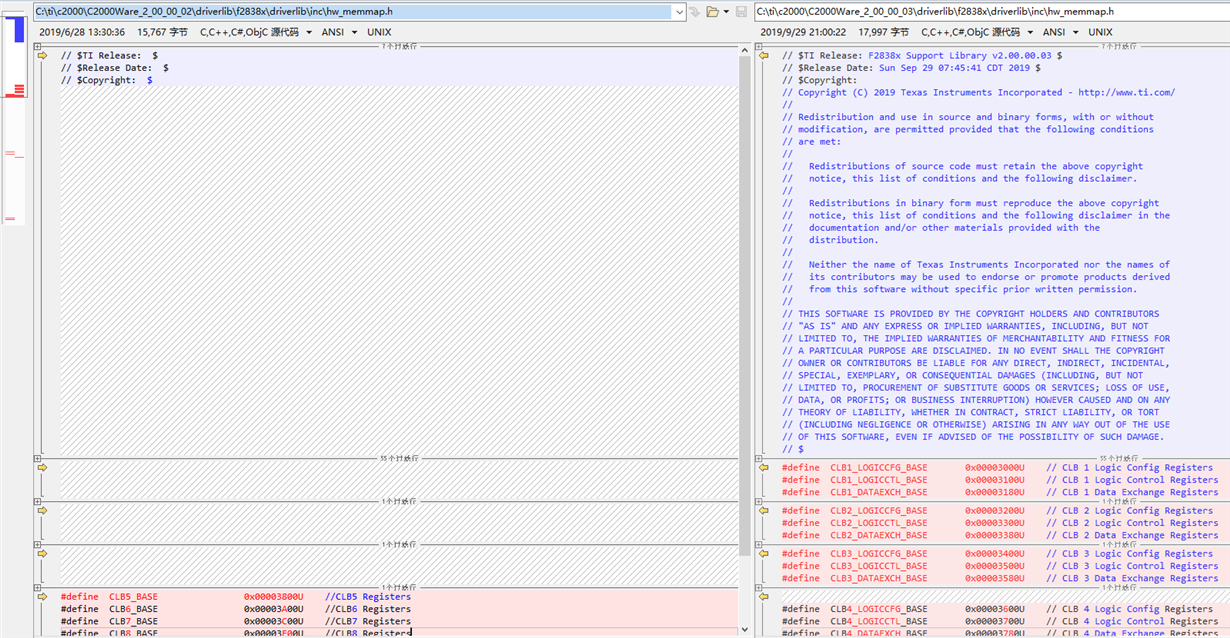

I found some code loss with the update of c2000ware from C2000Ware_2_00_00_02 to C2000Ware_2_00_00_03. For example, CLB5_BASE/CLB6_BASE/CLB7_BASE/CLB8_BASE are lost in new version (C2000Ware_2_00_00_03). Please refer the picture below for detailed information, thanks.
    This is expected .
    Currently we are only providing support for CLB tiles 1-4 for all devices F28x7x, F28004x and F2838x.
    These will be added back when they are completely supported by the device in one of the releases next year.
