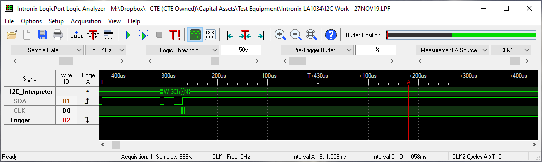

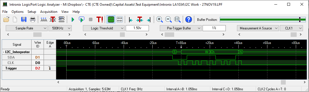

OK, now that that's out of the way, when I run the code, I see the slave being addressed on the I2C bus followed immediately by a NACK.  Nothing further happens.
The RXFFINT flag never gets set.  RXFFIENA enable bit is set.  I've confirmed the slave address is set to 0x3C.
It seems like the data never gets into the receive buffer of I2CB.

    Here it is with the correct hookup:
    So, please accept my apology and ignore that portion of my post.  I will go review your other response and let you know what I find.

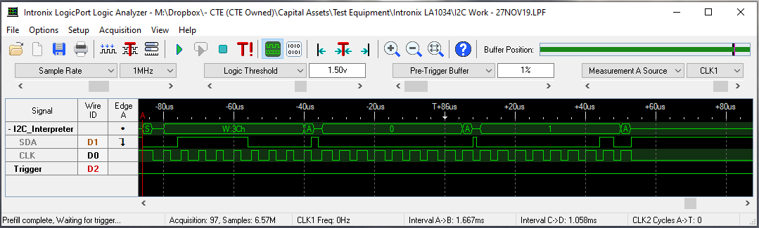

  • Hi Whitney,
    OK, if I add external pullups to SDAB & SCLB, then I get an ACK after sending the slave address.  But then, nothing else happens.
    However, if I set a breakpoint anywhere in the I2C_clearInterruptStatus() function, then it transmits and receives all data properly each time I hit the run button.  (Although I don't see a "stop").

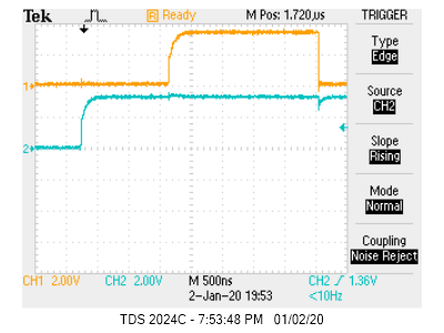

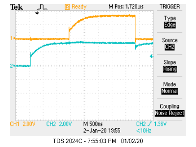

  • Hi Whitney,
    Here's the breakdown of why I wasn't getting data throughput from transmit to receive:
    The risetime of the SCL and SDA was insufficient.  By adding pullup resistors to both lines, the rise time is now sufficient for the hardware to do its thing.
    Here are the SCL & SDA lines without external pull up resistors:
    And here they are with 2.2k pull-ups to 3.3V:
    After installing the pull-ups, I was still having problems with the data transfer.  After reloading the example code from scratch and making the necessary modifications listed in my original post, all transfers worked properly.
    The secondary problem was with code mod's I had made during debugging that I hadn't reverted back.
    This issue is now resolved.
