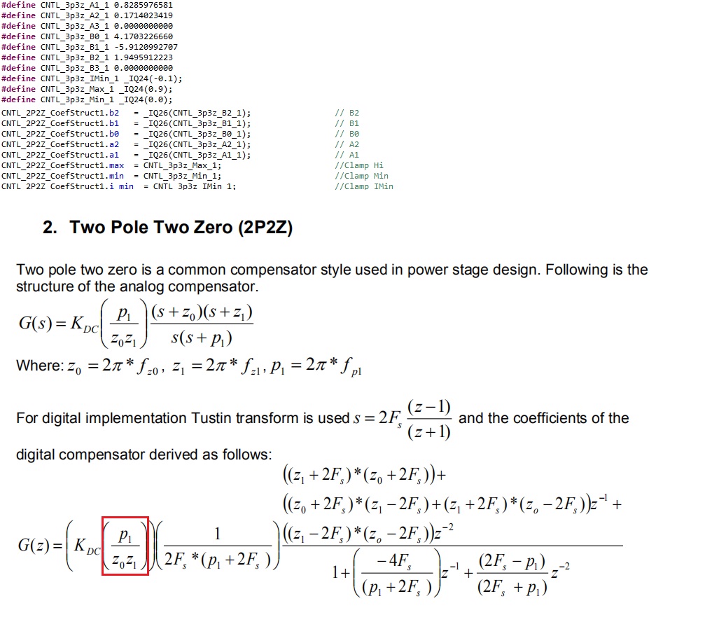

TMS320F28069M: Hi, guys, some confusion CNTL_2P2Z about the BOOSTXL_BUCKCONV demo board
Part Number: TMS320F28069M
Other Parts Discussed in Thread: SFRA, C2000WARE
  Hi, guys, some confusion CNTL_2P2Z about  the BOOSTXL_BUCKCONV demo board, see the picture belowing;
I have two question:
1) the demo example code give the a1/a2/b0/b1/b2 coefficient of the 2p2z, and what is the KDC/z0/z1/p1 ?
2) see he red box of the picture, I have confuse on it, because its unit is 1/Hz, is it right? may be is p1/(z0+z1) ? and why  the formula has the p1/(z0*z1) items ?
thanks.
  • The DC gain of the compensator without the integrator is z0*z1/p1.  It is dimensionless.  I think the author has divided by this term so that KDC sets the DC gain.  After everything has been multiplied out in the last equation, KDC*p1/(z0*z1) will become a common factor in the 'B' coefficients of the compensator.

  • Sure, let me try to make it a bit clearer.
    I did not provide an equation. With reference to the equation for G(s), I am saying if you remove the 's' term in the denominator (i.e. the integrator) and set the remaining 's' terms to zero you will have the DC gain of the compensator. It's equal to KDC*z0*z1/p1.
    When tuning the power supply loop, you're usually changing the compensator pole and zero frequencies and the compensator gain to achieve some target(s), such as bandwidth or phase margin. Once the gain and pole-zero frequencies are known you find the compensator coefficients using the formula in your first post. In other words, you start with the pole-zero frequencies and compute the coefficients.
    If you want to go in the other direction - to compute the gain & pole-zero frequencies from the coefficients - you would proceed as follows (with reference to the last equation in your first post):
    1. Normalize the numerator polynomial by dividing through by the constant term. This term is B0 in the coefficient list in the C code, and it's what I meant by the "common factor in the 'B' coefficients".
    2. Solve the numerator quadratic to find the compensator zeros.
    3. Solve the denominator quadratic to find the compensator poles.
    4. Now you have z0, z1, p1, and Fs, you can equate B0 to the product of the two bracketed terms on the left to find KDC.
    Normally, you would only want to do this if you need the pole-zero frequencies from an existing design.
    Richard

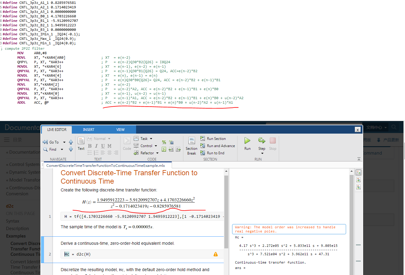

  •   Hi, Manish
           I use the Matlab d2c funtion you suggest to calculate the the G(s) by 'z' tems a1/a2/b0/b1/b2 cofficient . but it didn't happen what I want. see the below picture. can you point the wrong place or other suggestion?
          thanks.

  • The discrete conversion method used in DPlib was Tustin.  If you want to use the 2P2Z coefficients as a starting point and go backwards you'll need to specify the same method when you use 'd2c'.  See attached script.
    Richard
