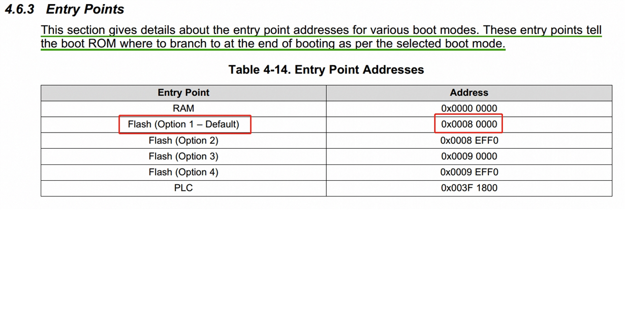

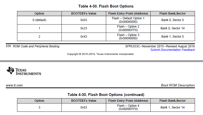

Hi
When TMS320F280049 starts up, the default entry of flash is 0x00080000. May I ask how to modify the configuration so that it can be started from other addresses in the table?
