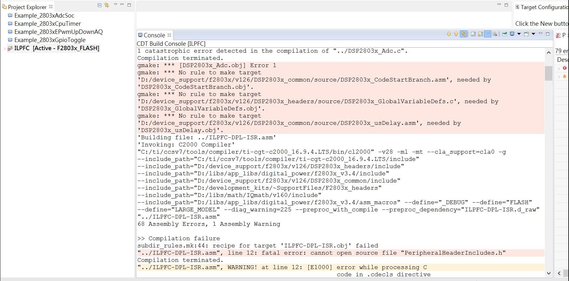

2)     To comment the program to Chinese traditional, I copied the whole ILFFC_v1.0 project directory and renamed it to ILPFC directory, then put it under D: \ ILPFC directory, then rebuilt, but the following errors occurred, how can I correct those errors?
How should I copy the directory so that I don't make any errors during rebuild?

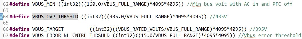

6)   About the ILPFC-Settings.h file in the ILPFC Ver. 1.0 project, Could you tell me in line 62 to line 67, what is meaning about 4095*4095 ?

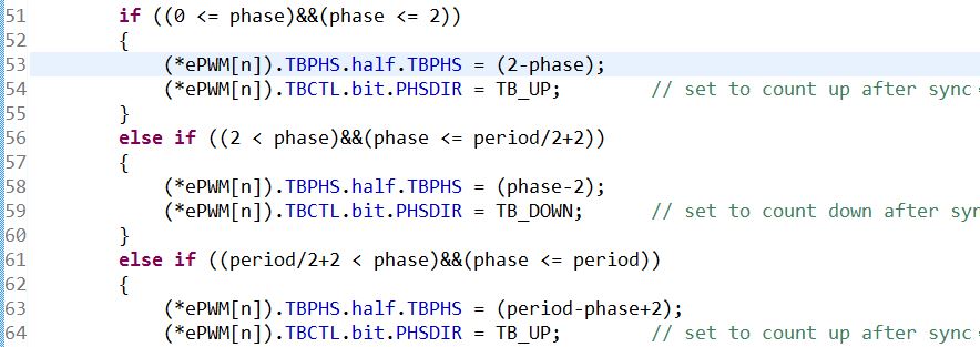

7)   About the PWM_2ch_UpDwnCnt_Cnt.c file, from line 51 to line 65, I can’t realize the meanings, could you explain for me ? specially in line 51, 56, and 61, what is the meaning in each line?

    2) It is due to the mismatch of the directory in the CCS. The project itself need some supporting files located in the controlSUITE/device support.. Two things you can do: a) you can reimport the project and select copy to workspace and change reference there. b) you can modify the reference directory in CCS by right clicking project name and select property/resource/linked resource and change the new routine where you paste the project.

    6. That is because those values are used for Q24(2^24) calculations.
    7. This is basically doing the phase shift based on different phase shift values under up-down count mode. You can draw a pic to understand different conditions. Please take a look at the counter compare submodule in PWM module in TRM.
