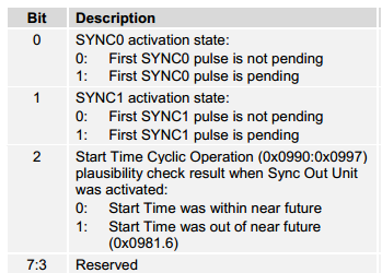

When EtherCAT enters Safe-Op state with DC Sync0 mode, the SYNC0 event should happen cyclically. However, it didn't happen. The raw status of SYNC0(ESCSS_INTR_RIS Register) is always zero. And the CM never enters the SYNC0 ISR.
I also checked the ESC register through TwinCAT as below. The 0x0980 and 0x0981 register were correct. And I found that ESC register 0x0984.Bit0=1, which means that the first SYNC0 pulse was pending.

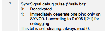

Then, I changed the ESC register 0x0981.Bit7 from 0 to 1 through TwinCAT, the CM entered SYNC0 interrupt  routine correctly.
