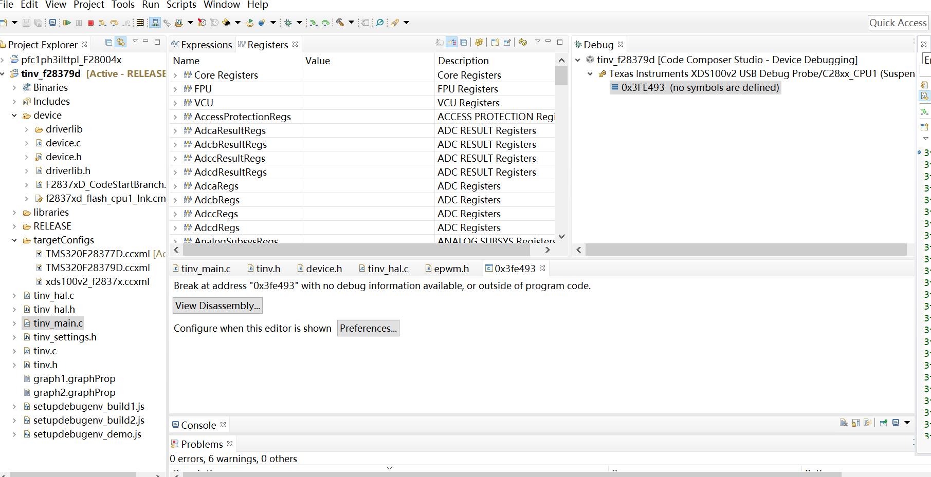

When I debug the program, I run the code online, click start, CCS will stop automatically, and then I find the following problems
Break at address "0x3fe493" with no debug information available, or outside of program code.
    If you have already loaded the code in flash and then trying to run it with CCS connected, please make sure you have set  EMULATION BOOT properly. You can get the detail about EMUALTION BOOT in device TRM (BOOTROM section).
