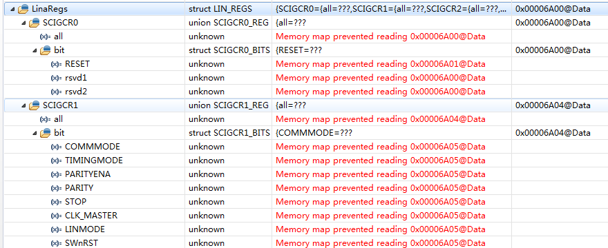

Customer could not read LINA register as picture shows, could you kindly give some suggestion?

Hi Sammi,
Which version of C2000Ware is the customer using?
Nirav
Hello
For certain byte addressing peripherals (LIN, CAN), the bitfield structures can't be viewed in CCS. You should instead use the CCS register tab or the memory window (using peripheral page).
This is something that the works to get fixed, however I am unsure about the timeline currently.
Best regards
Chris
Use the drop-down to switch from the "Data" page to the "peripheral" page.
