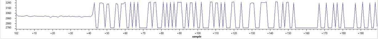

  • Very thanks for your answer. ADCINTSOCSEL1 and ADCINTSOCSEL2 registers were the problem. I was using "AdcOffsetSelfCal();" which is a function created by TI team and they put these registers set to 1.´The problem of using some code which you did not programm.

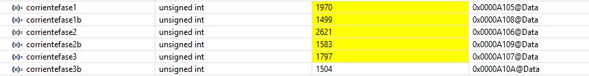

  • I still having a problem. I have modified the code as you recommended, but when the DSP read my signal, it does not read a logical value (I am working at 60 kHz):
    I set a 0,5 duty cycle in each PWM (I have 3, shifted 120 degrees). In the picture 2, we can see the currents that I want to control. I want to read the value in the middle of the climb in each phase (in the middle of the high PWM). So, I set: CMPB=dutyx*750. I attach the PWMs, to show that the converter works.
    So I expected a similar values between phases (2000 aprox), but I get the values that appear in the picture 1 (without "b", the pins with "b" are fedeed by a source) (they are stable, so I think that it is not a duration of conversion and calculation problem). In picture 1, corrientefase1=ADCRESULT0, corrientefase1b=ADCRESULT1, corrientefase2=ADCINTRESULT2, corrientefase2b=ADCINTRESULT3, corrientefase3=ADCINTRESULT4,corrientefase3b=ADCINTRESULT5.
    What can be the problem? How can I solve it? (I attach my fixed code)
    Very thaks for your time.
    Álvaro

  • Very thanks for your time, I am going to try to explain myself very concrete.
    One question is: Why is my ADC reading these values (they are variable, see picture) if I apply a constant value of 2.34 V with a constant source (first I apply 2.33 V, then I change to 2.34 V and the variable values appears)?
    I am using the same code.
    Very thanks for your time.
    Álvaro
  • Sorry, the step was from 2.24 V to 2.34 V

  • Álvaro,
    It looks to me like there may be some digital noise being injected at the board level. Are you activating some pin activity around the time the noise starts?
    I recommend placing an oscilloscope probe as close to the ADC pin as possible to determine if you can observe the noise directly.
    -Tommy

  • I am sure that they are being triggering. I configured a GPIO pin in each interruption, and it toggles its value when it should do it.
  • I noticed that the noise appear and disappear depending on the operation point of the board. But I do not find the relationship, I mean, where the noise come from. How can I avoid this noise? Because this noise introduce some big instabilities.
    Very thanks for your attention, it is being very helpful.
    Álvaro
    We are limited in our ability to assist with debugging board issues that are not directly related to our devices.
    Generally speaking, noise is usually generated by a noisy component, unstable circuit design, or poor signal integrity (PCB routing).
    I recommend setting a breakpoint in the ISR and observing the register updates as you single step through the code execution.
  • I have done it and I find that this expressioin is not well calculated:
    il2 = (AdcResult.ADCRESULT3-(AdcResult.ADCRESULT2-Offset))*0.00081;
    Where:
    il2 is a float
    Offset is a float
    AdcResult.ADCRESULTx are unsigned int.
    Can the mix of number types be a problem?
    Álvaro
