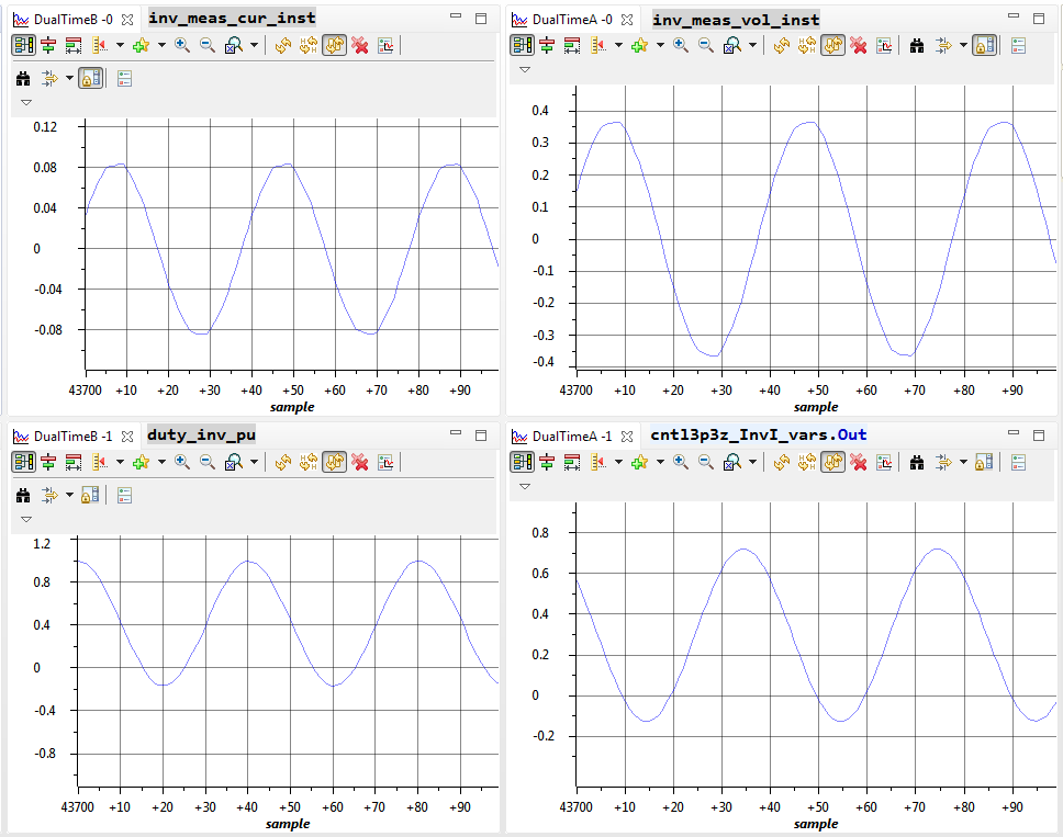

I have C2000 experimental kits with TMS320F28035 to start evaluating my product. I am using SolarMicroInv_F2803x exmaple source for reference for my project.
I facing issue : Duty cycle is calculated wrong with grid input current. I want to understand how it works in duty cycle calculation.
below is the copy paste of calculation for duty cylce from example.

How inv_meas_cur_inst value is impacted on dutycycle?
it's good for me, if someone explain me how above calculation is works?

    I understand current is added in duty_inv_pu, but what is the functionality of the following equation:
            CNTL_3P3Z_IQ_ASM(&cntl3p3z_InvI_coeff,&cntl3p3z_InvI_vars);
    Output "cntl3p3z_InvI_vars.Out" value is below zero levels. because of that duty_inv_pu has a wrong offset. so the result of this I am getting a duty cycle ~37 percentage.
    can you please explain what is the role of the above equation, why it's offset getting wrong?

    I have attached a snapshot of the graph for reference. Let me know you need any more information.
    Please guide me for a better understanding of this.
