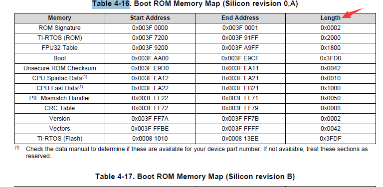

Dear TI engineers,
Diagram Table 4-16 and Table 4-17 of Boot ROM Memory Map in TMS320F28004x Microcontrollers Tech nical Reference Manual seems have fault in address length.
Which table should TMS320F280049C choose?
I could treat 0x3FF3B0 as the ROM start address and its length is 0xC10 when I use TMS320F28069. In this way, next address called RESET from 0x3FFFC0 to 3FFFC1. The last one called VECTORS come from 0X3FFFC2 to 0x400000.
If I want to still use this method to allocate address, how should I do?
