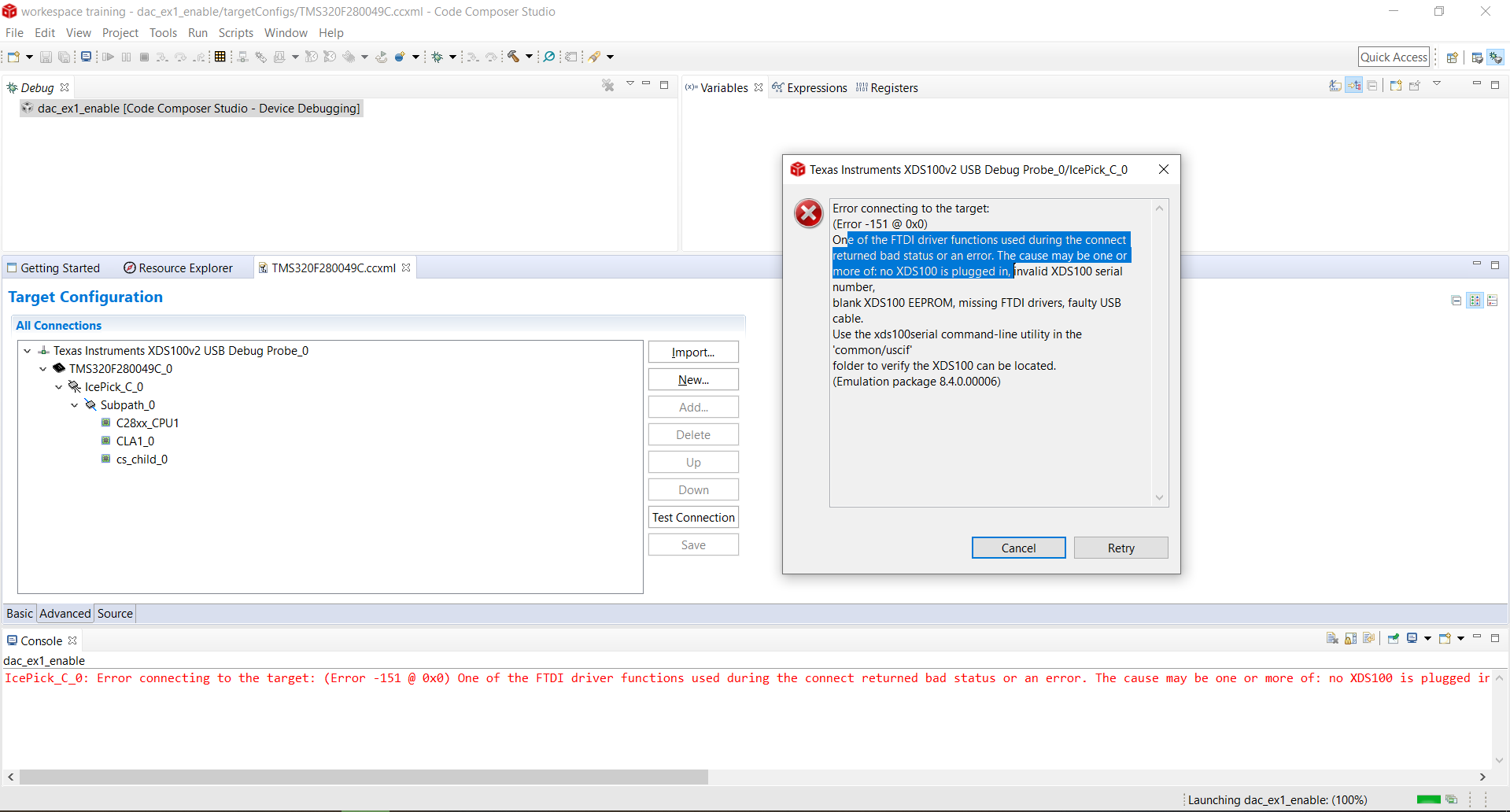

  • Hi there,  thank you for the answer!
    i think that TMDXDOCK280049M are still being on sell on couple of sites online (digikey/mouser).
    i am trying to open a example project but i am facing a problem to connect the device.
    i also tried to change the JTAG speed, but it did not work, and when i am running a connection check i get this massege:

  • Its very likely that you didn't connect power or a communications cable to the device. Can you provide a picture of your setup?
    Cody
  • you where right i accidentally connect the cable to the power connection.
    unfortunately i still have a problem.
    when i test the connection i get the error below, (i changed JTAG couple of times but it still shows the error )

  • Ok, can you pleasen provide an image of your setup, or describe what cables you have connected? Please be sure to include what connectors the USB cables are connected to.
    Cody
  • Hi, thank you for the answer
    Best Regards
    Michael
  • Michael,
    You have connected to and powered the embedded XDS100v2 emulator. However, you have not powered the C2000 device. Please connect a power supply to J1 or a USB cable to J17 of the docking station to provide power to the C2000 device.
    This design is used in many high-voltage system kits, so to protect user's computers we have implemented isolation between the Emulator and the C2000 device. Because of this they don't share the same power supply, and you will need to connect two USB cables, one for the emulator and one for the C2000 device.
    Cody
    its works,thank you.

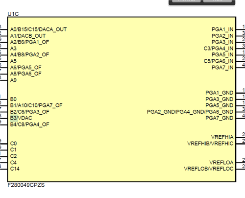

    I have couple of questions regarding to the sine wave generation.
    i am using an example project dac_ex1_enable (exmp for TMDSCNCD280049C):
    • what is a shadow value (// DAC Value Register - Shadow)?
    • I cant find  ADCINB3  at the attached schematic and why there is a need to a reference voltage?                                            .
    •                                                                                  "! \b External \b Connections \n
                                                                                        //!  - When the DAC reference is set to VDAC, an external reference voltage
                                                                                        //!    must be applied to the VDAC pin. This can be accomplished by connecting a
                                                                                        //!    jumper wire from 3.3V to ADCINB3."
    • i asumme that the output is DACA, is it right?

    the scematic:
    file:///C:/ti/c2000/C2000Ware_2_01_00_00/boards/controlCARDs/TMDSCNCD280049C/A/TMDSCNCD28004x_RevA_120cCARD_pinout.pdf
    Thank you very much!
    Michael
  • Michael,
    a shadow value is the next value to be loaded into a register after a set event. For example the DACHVALS register, see the register description below. This was taken from the Technical Reference Manual.
    High DAC shadow value. When COMPDACCTL[DACSOURCE]=0,
    the value of DACHVALS is loaded into DACHVALA on the trigger
    signal selected by COMPDACCTL[SWLOADSEL].
    I was unable to open the schematic you attached, so I opened the one included in C2000Ware for the F280049C controlCARD. ADCINB3 was shortened to B3, to make the schematic symbol more clean.
    Yes, there are two DAC outputs DACA and DACB, in the schematic these are called DACx_OUT.
    Cody
