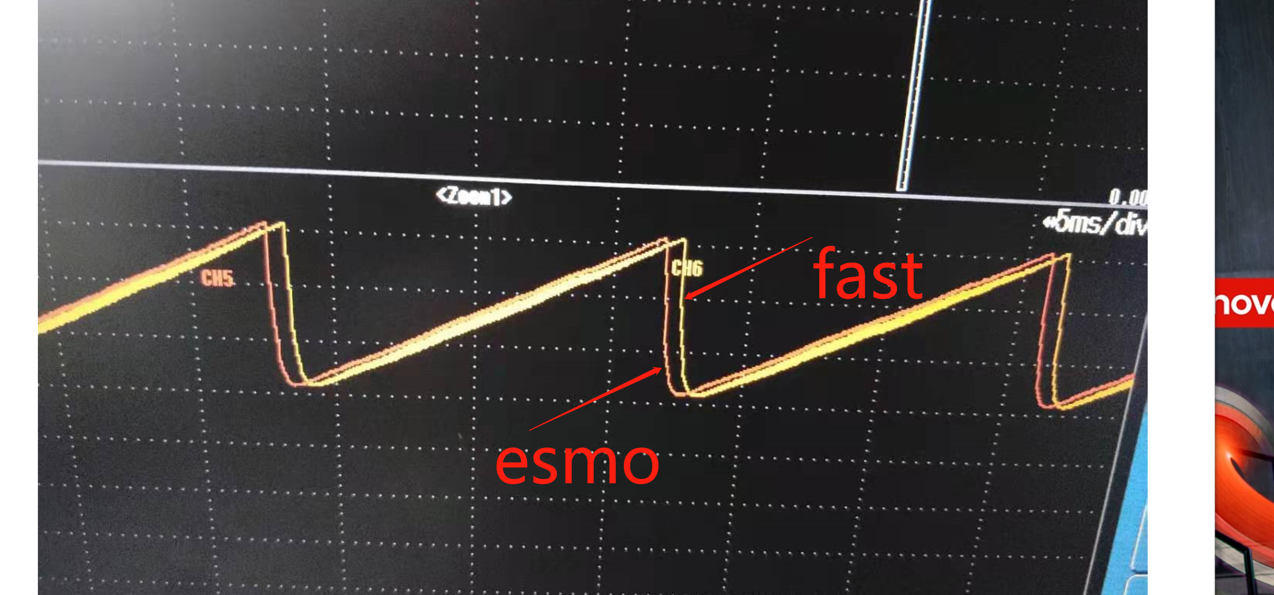

fast Estimated angle , esmo Estimated angle Different,Which one is more accurate?
Part Number: TMS320F28062F
If your FAST implementation used voltage feedback sensing for angle estimation, then FAST will be accurate.
