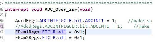

 at the beginning everything is ok, but when run the code for several seconds, the code will never enter ADC interrupt again, both the ADC sample and the code run in the main function are both ok, and we see from the ccs window that the ADC interrupt flag was not clear. if clear the ADC interrupt by manual in ccs window, then ADC interrupt can be accessed for several seconds , but after these several seconds then will never enter ADC interrupt again.
we use GPIO toggle to see exactly what happen and if any conflict. as below show yellow waveform show the time to enable the interrupt. green show if ADC interrupt happen. in normal case at the beginning the waveform is below:
then we capture the waveform when start to have issue as below:
we also capture the previous waveform of the issue happen below:
we guess there are two interrupt request almost at the same time when issue occur although in normal case the interrupt is trigger per 42us. when first interrupt occur, and enter the interrupt service code, there will have code to clear the interrupt flag. but at the same time the second interrupt occur and this interrupt flag was not clear,  then the code will never enter the interrupt service code again.

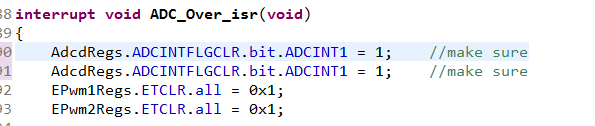

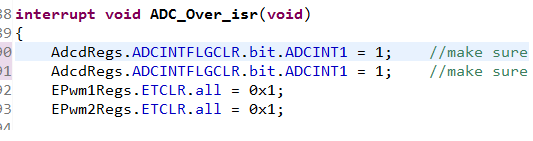

in order to verify this, we add one line code in the interrupt to clear the interrupt flag as below showed, so there are two line code to clear the interrupt flag twice,
it works and the issue is fixed.
question is what we guess is true and any principle to explain the phenomenon above?  any suggestion for the case that need to disable and reenable global interrupt in the while(1) function?

    Thanks for your reply, customer put the ADC interrupt flag clear and PIE acknowledge at the end of the  ISR code, still have this issue, only that clear the ADC interrupt flag twice in the interrupt can solve this problem.

    but this cannot explain why customer use ADCINTFLGCLR to clear flag twice as below that can resolve this issue? both of the clearing flag code was done at the beginning of the ISR, and there still have big possibility that another ADC interrupt is generated when the execution is still in ISR.
    and customer clear the flag at the end of ISR did not resolve this issue.
    customer care more about the root cause than how to fix this issue, any other interrupt mechanism or principle to explain this issue?
    I think this issue is due to interrupt overflow only. In case of interrrupt overflow condition follwing sequence should be used in ISR to recieve further interrupts.
    // adca1_isr - Read ADC Buffer in ISR
    interrupt void adca1_isr(void)
        AdcaResults[resultsIndex++] = AdcaResultRegs.ADCRESULT0;
        if(RESULTS_BUFFER_SIZE <= resultsIndex)
            resultsIndex = 0;
            bufferFull = 1;
        AdcaRegs.ADCINTFLGCLR.bit.ADCINT1 = 1; //clear INT1 flag
        // Check if overflow has occurred
        if(1 == AdcaRegs.ADCINTOVF.bit.ADCINT1)
            AdcaRegs.ADCINTOVFCLR.bit.ADCINT1 = 1; //clear INT1 overflow flag
        PieCtrlRegs.PIEACK.all = PIEACK_GROUP1;
    Refer to below e2e post for more details. Refer to the Errata document as well posted in the below post.
    https://e2e.ti.com/support/microcontrollers/c2000/f/171/t/814884?tisearch=e2e-sitesearch&keymatch=ADC%20interrupt%20overflow
    I think this is the reason why the customer code works, since it clears the int flag two times.
