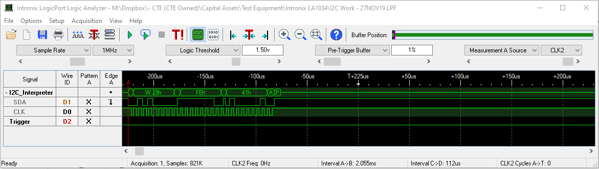

The i2c_ex1_loopback example loads and runs as expected, but I'm having a hard time understanding what's going on inside the code.
I've disabled loopback mode and inserted some I2C commands and data to populate a simple 2x16 char display.
Using the ISR to send data works until I issue a stop condition.  As long as I don't use a stop condition (using the existing function "I2C_sendStopCondition(I2CA_BASE);"), all data is received by the display and all is well.
However, if I insert a stop condition, none of the code following it will stream over the I2C bus.

Here's what the above code produces:  (all commands and data appear as expected and 2x16 display shows message correctly)

Here's what happens with a stop condition: (no data is sent over I2C bus after the stop)
If I look at the registers just before the start condition function is called, after the stop condition was previously called, the registers look like this:
The MST register is '0', so I suspect nothing else will be sent until it's back in master mode.  But, why did MST change to '0'?  What am I missing?  Do I need to reconfigure the I2C registers after every stop condition?
I've read the TMS320F28379D documentation (spruhm8i.pdf) several times, but I don't see what I'm doing wrong.

  • The technical reference manual description of MST does say that MST is automatically changed from 1 to 0 when the I2C master generates the STOP condition, so it sounds like that's the expected behavior. Does setting the MST bit again before trying your next transmission solve the issue?
    Whitney
  • Hi Whitney,
    Thanks for the reply.
    Yes, when resetting to master mode, I2C data will again transmit.
    I'd like to send I2C data to the display, then send the stop condition, then return to the main loop. In the main loop, things happen that change what the display should be displaying.  Once the array containing data for the display has been updated, I can't see how to initiate the fifo interrupt again.
    If no stop condition has occurred, then the processor spends all of its time in the I2C interrupt routine.  There's no time for the main loop to do anything.
    The problem I can't quite figure out now, is how to initiate a fifo interrupt after a stop condition has occurred.  TXFFINT is read only.
    TXFFST sets the threshold for comparison to TXFFIL (and will set TXFFINT when it drops below the value in TXFFIL), but TXFFST is read only, and it's set to 0x10.  How does TXFFST receive its value?  What is to the procedure to determine the value to set TXFFIL to?  My packets vary in byte length from 1 to as much as 16, so should I change TXFFIL each time the packet size changes?
