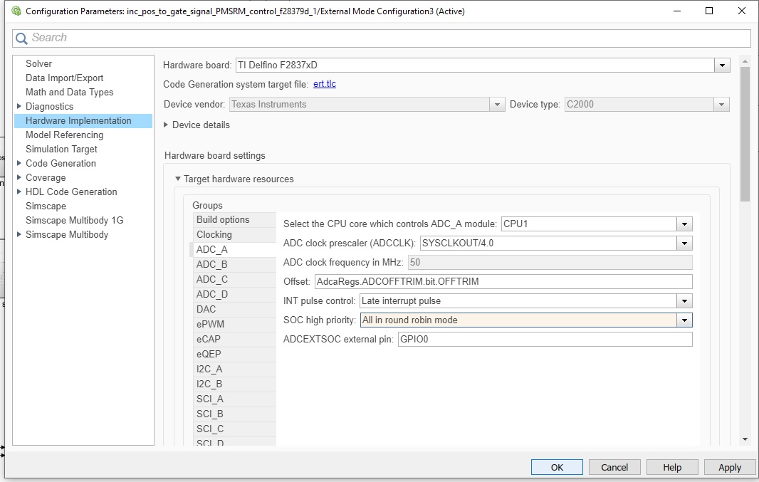

I have been trying to make voltage signal measurement from Matlab/simulink through an ADC of F28379D. It works fine with DC voltage measurement, for example when I change the DC voltage from 1 to 3 V.  Please see the following figure.
However, when I would like to measure an AC signal with amplitude of 3V and an offset of 1.5V, it just measures a kind of noise as seen in the following, even at low frequency (100Hz).
 I have used voltage follower (buffer) to make an impedance matching between the microprocessor ADC and source but nothing changed. Is there any way of fixing this problem?
Here are the setting for hardware and ADC.
Thank you in advance.
