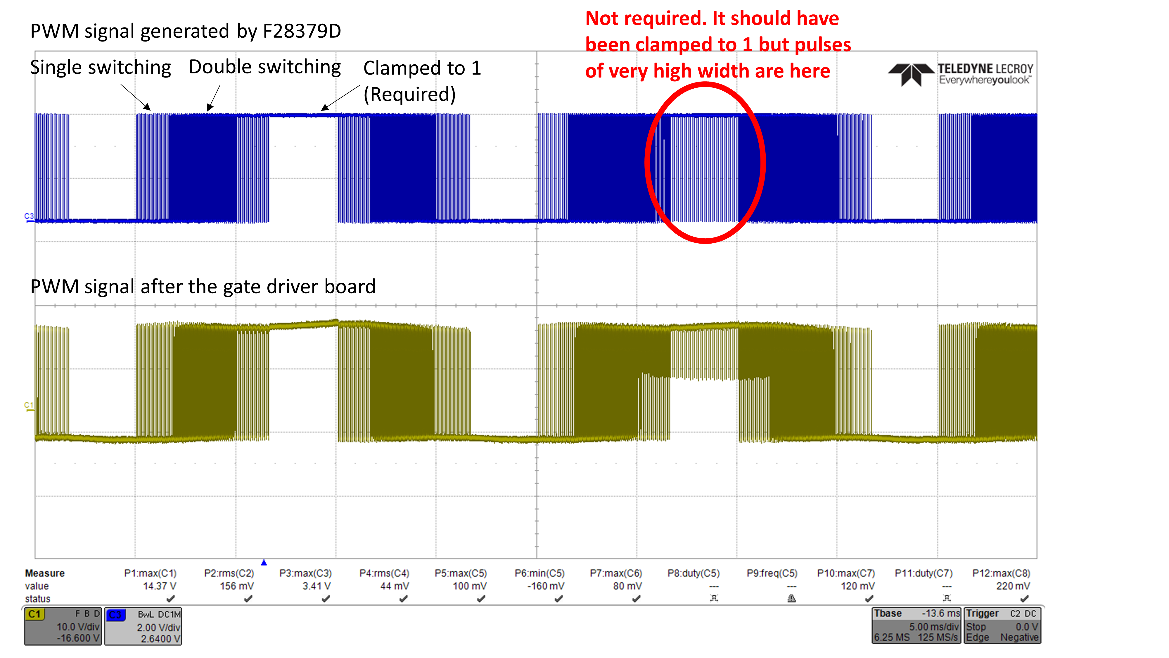

I am working on Advanced Bus Clamped PWM Method (ABC-PWM) using space vector that involves double switching of a phase in specific sector number. I have implemented a space vector Macro for its implementation with 12 sectors since the applied switching sequence has to change after every 30 degrees. But I am facing a problem in portions where phase is supposed to double switch. For the ABC-PWM, I require:
Phase A (PWM12) to double switch in Sector 1,2,7,8
Phase B (PWM11) to double switch in Sector 3,4,9,10
Phase C (PWM9) to double switch in Sector 5,6,11,12
For this double switching, I have used Compare 'B' Registers (EPwmxxRegs.CMPB.bit.CMPB) of the respective PWM signals since  Compare 'A' Registers were already used in normal switching.
I have implemented following code for double switching:
if ((svgen1.VecSector == 1)||(svgen1.VecSector == 2)||(svgen1.VecSector == 7)||(svgen1.VecSector == 8))
EPwm12Regs.CMPB.bit.CMPB = usCmpValD; //phase B double switches is sector 1 & 2
EPwm12Regs.AQCTLA.bit.CBU = AQ_SET;
EPwm12Regs.AQCTLA.bit.CBD = AQ_CLEAR;
EPwm12Regs.AQCTLB.bit.CBU = AQ_CLEAR;
EPwm12Regs.AQCTLB.bit.CBD = AQ_SET;
else if ((svgen1.VecSector == 3)||(svgen1.VecSector == 4)||(svgen1.VecSector == 9)||(svgen1.VecSector == 10))
EPwm11Regs.CMPB.bit.CMPB = usCmpValD; //phase A double switches is sector 1 & 2
EPwm11Regs.AQCTLA.bit.CBU = AQ_SET;
EPwm11Regs.AQCTLA.bit.CBD = AQ_CLEAR;
EPwm11Regs.AQCTLB.bit.CBU = AQ_CLEAR;
EPwm11Regs.AQCTLB.bit.CBD = AQ_SET;
else if ((svgen1.VecSector == 5)||(svgen1.VecSector == 6)||(svgen1.VecSector == 11)||(svgen1.VecSector == 12))
EPwm9Regs.CMPB.bit.CMPB = usCmpValD; //phase C double switches is sector 1 & 2
EPwm9Regs.AQCTLA.bit.CBU = AQ_SET;
EPwm9Regs.AQCTLA.bit.CBD = AQ_CLEAR;
EPwm9Regs.AQCTLB.bit.CBU = AQ_CLEAR;
EPwm9Regs.AQCTLB.bit.CBD = AQ_SET;

   /* svgen1.Ualpha = fUmodAlpha * VdTesting;
    svgen1.Ubeta  = fUmodBeta * VdTesting;
        svgen1.Vref = VdTesting;
        svgen1.omegat = rg1.Out*TWO_PI;
//    svgen1.Ualpha = fUmodAlpha * fMI240;
//    svgen1.Ubeta  = fUmodBeta  * fMI240;
  /*  // DPWM 1 (clamp at peak)
    fUma = ipark1.Alpha;
    fUmb = 0.5*( 1.732050807 * ipark1.Beta - ipark1.Alpha);
    fUmc = 0.5*(-1.732050807 * ipark1.Beta - ipark1.Alpha);
    fUmax = MAX_THREE(fUma, fUmb, fUmc);
    fUmin = MIN_THREE(fUma, fUmb, fUmc);
    fUmaxAbs = ABS(fUmax);
    fUminAbs = ABS(fUmin);
    if( fUmaxAbs > fUminAbs )
        fUmz = 1.0 - fUmax;
    else
        fUmz = -1.0 - fUmin;
    fUmodA = fUma + fUmz;
    fUmodB = fUmb + fUmz;
    fUmodC = fUmc + fUmz;
    //240CPWM
 SVGENDPWM_240_MACRO(svgen1)
   fUmodA = -svgen1.Ta;
   fUmodB = -svgen1.Tb;
   fUmodC = -svgen1.Tc;
//    SVGENASCPWM_MACRO(svgen1)
   SVGENACCPWM_MACRO(svgen1)
//   SVGENDQ_MACRO(svgen1)
//   SVGENDPWM1_MACRO(svgen1)
   fUmodA = svgen1.Ta;
   fUmodB = svgen1.Tb;
   fUmodC = svgen1.Tc;
   fUmodD = svgen1.Td;
//    if( fVaAbs > fDBCompThres )
//        fDBCompA = fDBCompCoeff;
//    if( fVbAbs > fDBCompThres )
//        fDBCompB = fDBCompCoeff;
//    if( fVcAbs > fDBCompThres )
//        fDBCompC = fDBCompCoeff;
//    fUmodA = fUmodA * fDBCompA;
//    fUmodB = fUmodB * fDBCompB;
//    fUmodC = fUmodC * fDBCompC;
    usCmpValA = (INV_PWM_HALF_TBPRD * fUmodA) + INV_PWM_HALF_TBPRD;
    usCmpValB = (INV_PWM_HALF_TBPRD * fUmodB) + INV_PWM_HALF_TBPRD;
    usCmpValC = (INV_PWM_HALF_TBPRD * fUmodC) + INV_PWM_HALF_TBPRD;
    usCmpValD = (INV_PWM_HALF_TBPRD * fUmodD) + INV_PWM_HALF_TBPRD;
    UP_DOWN_LIMIT(usCmpValA, INV_PWM_TBPRD, 0);
    UP_DOWN_LIMIT(usCmpValB, INV_PWM_TBPRD, 0);
    UP_DOWN_LIMIT(usCmpValC, INV_PWM_TBPRD, 0);
    UP_DOWN_LIMIT(usCmpValD, INV_PWM_TBPRD, 0);
    EPwm11Regs.CMPA.bit.CMPA = usCmpValA; //phase A
    EPwm12Regs.CMPA.bit.CMPA = usCmpValB; //phase B
    EPwm9Regs.CMPA.bit.CMPA  = usCmpValC; //phase C
         EPwm11Regs.CMPB.bit.CMPB = usCmpValD; //phase B double switches is sector 1 & 2
         EPwm9Regs.CMPB.bit.CMPB = usCmpValD; //phase B double switches is sector 1 & 2

//        UP_DOWN_LIMIT(fCurrCtrlB, 0.8, 0.2);
//        fIerrC = fCurrentRef - fIindCFlt;
//        fIntC += fIerrC * fKi * CONTROL_PERIOD;
//        UP_DOWN_LIMIT(fIntC, 0.8, -0.8);
//        fCurrCtrlC = fKp * fIerrC + fIntC;
//        UP_DOWN_LIMIT(fCurrCtrlC, 0.8, 0.2);
//        fDutyCycle  = 1.0 - fCurrCtrlA; // fDutyCycle is duty for top switch (Q1), fD0 is for Q2
//        fDutyCycle2 = 1.0 - fCurrCtrlB;
//        fDutyCycle3 = 1.0 - fCurrCtrlC;
        EPwm1_CMP = (Uint16)(fDutyCycle *  (0.5 * (float32)CONTROL_TBPRD));
        EPwm2_CMP = (Uint16)(fDutyCycle2 * (0.5 * (float32)CONTROL_TBPRD));
        EPwm3_CMP = (Uint16)(fDutyCycle3 * (0.5 * (float32)CONTROL_TBPRD));
        EPwm1Regs.CMPA.bit.CMPA = EPwm1_CMP; // Phase A Main
        EPwm2Regs.CMPA.bit.CMPA = EPwm2_CMP; // Phase B Main
        EPwm3Regs.CMPA.bit.CMPA = EPwm3_CMP; // Phase C Main
    else
        Shutdown();
//    EPwm1_DB = (Uint16)(fTdb * 0.1);
//    EPwm11Regs.DBFED.bit.DBFED = EPwm1_DB;
//    EPwm12Regs.DBFED.bit.DBFED = EPwm1_DB;
//    EPwm9Regs.DBFED.bit.DBFED = EPwm1_DB;
//    //  Connect inputs of the DATALOG module
//    DlogCh1 = svgen1.Ta;
//    DlogCh2 = svgen1.Tb;
//    DlogCh3 = svgen1.Tc;
//    DlogCh4 = DlogCh2 - DlogCh3;
//    //    Call the DATALOG update function.
//    DLOG_4CH_F_FUNC(&dlog_4ch1);
    // View data in CCS graph
    if( usStartSaveData == 1 )
        saveIndex++;
        if( (bufferFull == 0) && (samplePace <= saveIndex) )
//            Adc1[resultsIndex] = fVinFlt * 1.0;
//            Adc2[resultsIndex] = fVdcRef * 1.0;
//            Adc3[resultsIndex] = fUmodA * 1000.0;
//            Adc4[resultsIndex] = fDutyCycle * 1000.0;
           /* Adc1[resultsIndex] = fVabAbs * 1000.0;
            Adc2[resultsIndex] = fVbcAbs * 1000.0;
            Adc3[resultsIndex] = fVdc * 10.0;
            Adc4[resultsIndex] = fVdcRef * 10.0;*/
            Adc1[resultsIndex] = svgen1.Ta * 100.0;
            Adc2[resultsIndex] = svgen1.Tb * 100.0;
            Adc3[resultsIndex] = svgen1.Tc * 100.0;
            Adc4[resultsIndex] = svgen1.Td * 100.0;
            resultsIndex++;
            saveIndex = 0;
        if(RESULTS_BUFFER_SIZE <= resultsIndex)
            resultsIndex = 0;
            bufferFull = 1;
            saveIndex = 0;
            usStartSaveData = 0;
    // GpioDataRegs.GPACLEAR.bit.GPIO6 = 1;
    AdcaRegs.ADCINTFLGCLR.bit.ADCINT1 = 1; //clear INT1 flag
    PieCtrlRegs.PIEACK.all = PIEACK_GROUP1;
// InitEPwm - Initialize EPWMx configuration
void InitEPwm()
    fTdb  = 250.0; // ns
    fTdb2 = 250.0; // ns
    fTdb3 = 250.0; // ns
    EPwm2_DB = (Uint16)(fTdb2 * 0.1);
    EPwm3_DB = (Uint16)(fTdb3 * 0.1);
    fDutyCycle = 0.3;
    usPhase = (Uint16)(0.666666 * 0.5 * (float32)CONTROL_TBPRD);
    usPwm2Phase = usPhase; // Phase B Main
    usPwm3Phase = usPhase; // Phase C Main
    EPwm1Regs.TBPRD = (Uint16)(0.5 * (float32)CONTROL_TBPRD);                       // Set timer period
    EPwm1Regs.TBPHS.bit.TBPHS = 0x0000;           // Phase is 0
    EPwm1Regs.TBCTR = 0x0000;                     // Clear counter
    EPwm1Regs.TBCTL.bit.CTRMODE = TB_COUNT_UPDOWN; // Count up-down
    EPwm1Regs.TBCTL.bit.PHSEN = TB_DISABLE;        // Disable phase loading
    EPwm1Regs.TBCTL.bit.PRDLD = TB_SHADOW;
    EPwm1Regs.TBCTL.bit.SYNCOSEL = TB_CTR_ZERO; // Sync Output Select: CTR = zero
//    EPwm1Regs.rsvd2[0] = 0x0002; // EPWMxSYNCOUT Source Enable Register
    EPwm1Regs.TBCTL.bit.HSPCLKDIV = TB_DIV1;       // Clock ratio to SYSCLKOUT
    EPwm1Regs.TBCTL.bit.CLKDIV = TB_DIV1;
    EPwm1Regs.CMPCTL.bit.SHDWAMODE = CC_SHADOW;    // Load registers every ZERO
    EPwm1Regs.CMPCTL.bit.SHDWBMODE = CC_SHADOW;
    EPwm1Regs.CMPCTL.bit.LOADAMODE = CC_CTR_ZERO;
    EPwm1Regs.CMPCTL.bit.LOADBMODE = CC_CTR_ZERO;
//    EPwm1Regs.CMPA.bit.CMPA = (Uint16)(fDutyCycle * (float32)CONTROL_TBPRD);
    EPwm1Regs.AQCTLA.bit.CAU = AQ_CLEAR;            // Set PWM1A on Zero
    EPwm1Regs.AQCTLA.bit.CAD = AQ_SET;
    EPwm1Regs.AQCTLB.bit.CAU = AQ_SET;          // Set PWM1A on Zero
    EPwm1Regs.AQCTLB.bit.CAD = AQ_CLEAR;
    EPwm1Regs.AQSFRC.bit.RLDCSF = 3; // Load immediately
    EPwm1Regs.DBCTL.bit.OUT_MODE = DB_FULL_ENABLE;
    EPwm1Regs.DBCTL.bit.POLSEL = DB_ACTV_HIC;
    EPwm1Regs.DBCTL.bit.IN_MODE = DBA_ALL;
    EPwm1Regs.DBRED.bit.DBRED = EPwm1_DB;
    EPwm1Regs.DBFED.bit.DBFED = EPwm1_DB;
    EPwm2Regs.TBPRD = (Uint16)(0.5 * (float32)CONTROL_TBPRD);                       // Set timer period
    EPwm2Regs.TBPHS.bit.TBPHS = usPwm2Phase;           // Phase is 0
    EPwm2Regs.TBCTR = 0x0000;                     // Clear counter
    EPwm2Regs.TBCTL.bit.CTRMODE = TB_COUNT_UPDOWN; // Count up-down
    EPwm2Regs.TBCTL.bit.PHSEN = TB_ENABLE;        // Disable phase loading
    EPwm2Regs.TBCTL.bit.PHSDIR = TB_DOWN;               // Count down after the synchronization event
    EPwm2Regs.TBCTL.bit.PRDLD = TB_SHADOW;
    EPwm2Regs.TBCTL.bit.SYNCOSEL = TB_SYNC_IN;
//    EPwm2Regs.rsvd2[0] = 0x0002; // EPWMxSYNCOUT Source Enable Register
    EPwm2Regs.TBCTL.bit.HSPCLKDIV = TB_DIV1;       // Clock ratio to SYSCLKOUT
    EPwm2Regs.TBCTL.bit.CLKDIV = TB_DIV1;
    EPwm2Regs.CMPCTL.bit.SHDWAMODE = CC_SHADOW;    // Load registers every ZERO
    EPwm2Regs.CMPCTL.bit.SHDWBMODE = CC_SHADOW;
    EPwm2Regs.CMPCTL.bit.LOADAMODE = CC_CTR_ZERO;
    EPwm2Regs.CMPCTL.bit.LOADBMODE = CC_CTR_ZERO;
//    EPwm2Regs.CMPA.bit.CMPA = (Uint16)(fDutyCycle * (float32)CONTROL_TBPRD);
    EPwm2Regs.AQCTLA.bit.CAU = AQ_CLEAR;            // Set PWM1A on Zero
    EPwm2Regs.AQCTLA.bit.CAD = AQ_SET;
    EPwm2Regs.AQCTLB.bit.CAU = AQ_SET;          // Set PWM1A on Zero
    EPwm2Regs.AQCTLB.bit.CAD = AQ_CLEAR;
    EPwm2Regs.AQSFRC.bit.RLDCSF = 3; // Load immediately
    EPwm2Regs.DBCTL.bit.OUT_MODE = DB_FULL_ENABLE;
    EPwm2Regs.DBCTL.bit.POLSEL = DB_ACTV_HIC;
    EPwm2Regs.DBCTL.bit.IN_MODE = DBA_ALL;
    EPwm2Regs.DBRED.bit.DBRED = EPwm2_DB;
    EPwm2Regs.DBFED.bit.DBFED = EPwm2_DB;
    EPwm3Regs.TBPRD = (Uint16)(0.5 * (float32)CONTROL_TBPRD);                       // Set timer period
    EPwm3Regs.TBPHS.bit.TBPHS = usPwm3Phase;           // Phase is 0
    EPwm3Regs.TBCTR = 0x0000;                     // Clear counter
    EPwm3Regs.TBCTL.bit.CTRMODE = TB_COUNT_UPDOWN; // Count up-down
    EPwm3Regs.TBCTL.bit.PHSEN = TB_ENABLE;        // Disable phase loading
    EPwm3Regs.TBCTL.bit.PHSDIR = TB_UP;               // Count down/up (0/1) after the synchronization event
    EPwm3Regs.TBCTL.bit.PRDLD = TB_SHADOW;
    EPwm3Regs.TBCTL.bit.SYNCOSEL = TB_SYNC_IN;
//    EPwm3Regs.rsvd2[0] = 0x0002; // EPWMxSYNCOUT Source Enable Register
    EPwm3Regs.TBCTL.bit.HSPCLKDIV = TB_DIV1;       // Clock ratio to SYSCLKOUT
    EPwm3Regs.TBCTL.bit.CLKDIV = TB_DIV1;
    EPwm3Regs.CMPCTL.bit.SHDWAMODE = CC_SHADOW;    // Load registers every ZERO
    EPwm3Regs.CMPCTL.bit.SHDWBMODE = CC_SHADOW;
    EPwm3Regs.CMPCTL.bit.LOADAMODE = CC_CTR_ZERO;
    EPwm3Regs.CMPCTL.bit.LOADBMODE = CC_CTR_ZERO;
//    EPwm3Regs.CMPA.bit.CMPA = (Uint16)(fDutyCycle * (float32)CONTROL_TBPRD);
    EPwm3Regs.AQCTLA.bit.CAU = AQ_CLEAR;            // Set PWM1A on Zero
    EPwm3Regs.AQCTLA.bit.CAD = AQ_SET;
    EPwm3Regs.AQCTLB.bit.CAU = AQ_SET;          // Set PWM1A on Zero
    EPwm3Regs.AQCTLB.bit.CAD = AQ_CLEAR;
    EPwm3Regs.AQSFRC.bit.RLDCSF = 3; // Load immediately
    EPwm3Regs.DBCTL.bit.OUT_MODE = DB_FULL_ENABLE;
    EPwm3Regs.DBCTL.bit.POLSEL = DB_ACTV_HIC;
    EPwm3Regs.DBCTL.bit.IN_MODE = DBA_ALL;
    EPwm3Regs.DBRED.bit.DBRED = EPwm3_DB;
    EPwm3Regs.DBFED.bit.DBFED = EPwm3_DB;
    // Interrupt setting
//    EPwm1Regs.ETSEL.bit.INTSEL = ET_CTR_ZERO;    // Select INT on Zero event
//    EPwm1Regs.ETPS.bit.INTPRD = ET_2ND;          // Generate INT on 1st event
//    EPwm1Regs.ETSEL.bit.INTEN = 1;               // Enable INT
    // ADC SOC
    EALLOW;
    EPwm1Regs.ETSEL.bit.SOCASEL = 1;   // Select SOC on Zero
    EPwm1Regs.ETSEL.bit.SOCAEN = 1;  //enable SOCA
    EPwm1Regs.ETPS.bit.SOCAPRD = ET_2ND;       // Generate pulse on ___ event
    EDIS;
    //    EPwm1Regs.TBPRD = CONTROL_TBPRD;                       // Set timer period
    //    EPwm1Regs.TBPHS.bit.TBPHS = 0x0000;           // Phase is 0
    //    EPwm1Regs.TBCTR = 0x0000;                     // Clear counter
    //    EPwm1Regs.TBCTL.bit.CTRMODE = TB_COUNT_UPDOWN; // Count up-down
    //    EPwm1Regs.TBCTL.bit.PHSEN = TB_DISABLE;        // Disable phase loading
    //    EPwm1Regs.TBCTL.bit.SYNCOSEL = 1; // Sync Output Select: CTR = zero
    //    EPwm1Regs.TBCTL.bit.HSPCLKDIV = TB_DIV1;       // Clock ratio to SYSCLKOUT
    //    EPwm1Regs.TBCTL.bit.CLKDIV = TB_DIV1;
    //    EPwm1Regs.CMPCTL.bit.SHDWAMODE = CC_SHADOW;    // Load registers every ZERO
    //    EPwm1Regs.CMPCTL.bit.SHDWBMODE = CC_SHADOW;
    //    EPwm1Regs.CMPCTL.bit.LOADAMODE = CC_CTR_ZERO;
    //    EPwm1Regs.CMPCTL.bit.LOADBMODE = CC_CTR_ZERO;
    //   // EPwm1Regs.CMPA.bit.CMPA = (Uint16)(fDutyCycle * (float32)PWM_PRD_UD);
    //    EPwm1Regs.AQCTLA.bit.CAU = AQ_CLEAR;            // Set PWM1A on Zero
    //    EPwm1Regs.AQCTLA.bit.CAD = AQ_SET;
    //    EPwm1Regs.AQCTLB.bit.CAU = AQ_SET;          // Set PWM1A on Zero
    //    EPwm1Regs.AQCTLB.bit.CAD = AQ_CLEAR;
    //    EPwm1Regs.AQSFRC.bit.RLDCSF = 3; // Load immediately
    //    EPwm1Regs.DBCTL.bit.OUT_MODE = DB_FULL_ENABLE;
    //    EPwm1Regs.DBCTL.bit.POLSEL = DB_ACTV_HIC;
    //    EPwm1Regs.DBCTL.bit.IN_MODE = DBA_ALL;
    //    EPwm1Regs.DBRED.bit.DBRED = EPwm1_DB;
    //    EPwm1Regs.DBFED.bit.DBFED = EPwm1_DB;
    // PWM modules for 3-phase inverter
    // EPWM 11, 12, 9
    EPwm11Regs.TBPRD = INV_PWM_TBPRD;                       // Set timer period
    EPwm11Regs.TBPHS.bit.TBPHS = 0x0000;           // Phase is 0
    EPwm11Regs.TBCTR = 0x0000;                     // Clear counter
    EPwm11Regs.TBCTL.bit.CTRMODE = TB_COUNT_UPDOWN; // Count up-down
    EPwm11Regs.TBCTL.bit.PHSEN = TB_DISABLE;        // Disable phase loading
    EPwm11Regs.TBCTL.bit.SYNCOSEL = 1; // Sync Output Select: CTR = zero
    EPwm11Regs.rsvd2[0] = 0x0002; // EPWMxSYNCOUT Source Enable Register
    EPwm11Regs.TBCTL.bit.HSPCLKDIV = TB_DIV1;       // Clock ratio to SYSCLKOUT
    EPwm11Regs.TBCTL.bit.CLKDIV = TB_DIV1;
//    EPwm11Regs.CMPA.bit.CMPA = (Uint16)(fDutyCycle * (float32)INV_PWM_HALF_TBPRD);
    EPwm11Regs.CMPCTL.bit.SHDWAMODE = CC_SHADOW;    // Load registers every ZERO
    EPwm11Regs.CMPCTL.bit.SHDWBMODE = CC_SHADOW;
    EPwm11Regs.CMPCTL.bit.LOADAMODE = CC_CTR_ZERO_PRD;
    EPwm11Regs.CMPCTL.bit.LOADBMODE = CC_CTR_ZERO_PRD;
    EPwm11Regs.AQCTLA.bit.CAU = AQ_CLEAR;            // Set PWM1A on Zero
    EPwm11Regs.AQCTLA.bit.CAD = AQ_SET;
    EPwm11Regs.AQCTLB.bit.CAU = AQ_SET;          // Set PWM1A on Zero
    EPwm11Regs.AQCTLB.bit.CAD = AQ_CLEAR;
    EPwm11Regs.AQSFRC.bit.RLDCSF = 3; // Load immediately
    EPwm11Regs.DBCTL.bit.OUT_MODE = DB_FULL_ENABLE;
    EPwm11Regs.DBCTL.bit.POLSEL = DB_ACTV_HIC;
    EPwm11Regs.DBCTL.bit.IN_MODE = DBA_ALL;
    EPwm11Regs.DBRED.bit.DBRED = EPwm1_DB;
    EPwm12Regs.TBPRD = INV_PWM_TBPRD;                       // Set timer period
    EPwm12Regs.TBPHS.bit.TBPHS = 0x0000;           // Phase is 0
    EPwm12Regs.TBCTR = 0x0000;                     // Clear counter
    EPwm12Regs.TBCTL.bit.CTRMODE = TB_COUNT_UPDOWN; // Count up-down
    EPwm12Regs.TBCTL.bit.PHSEN = TB_DISABLE;        // Disable phase loading
    EPwm12Regs.TBCTL.bit.SYNCOSEL = 1; // Sync Output Select: CTR = zero
    EPwm12Regs.rsvd2[0] = 0x0002; // EPWMxSYNCOUT Source Enable Register
    EPwm12Regs.TBCTL.bit.HSPCLKDIV = TB_DIV1;       // Clock ratio to SYSCLKOUT
    EPwm12Regs.TBCTL.bit.CLKDIV = TB_DIV1;
//    EPwm12Regs.CMPA.bit.CMPA = (Uint16)(fDutyCycle * (float32)INV_PWM_HALF_TBPRD);
    EPwm12Regs.CMPCTL.bit.SHDWAMODE = CC_SHADOW;    // Load registers every ZERO
    EPwm12Regs.CMPCTL.bit.SHDWBMODE = CC_SHADOW;
    EPwm12Regs.CMPCTL.bit.LOADAMODE = CC_CTR_ZERO_PRD;
    EPwm12Regs.CMPCTL.bit.LOADBMODE = CC_CTR_ZERO_PRD;
    EPwm12Regs.AQCTLA.bit.CAU = AQ_CLEAR;            // Set PWM1A on Zero
    EPwm12Regs.AQCTLA.bit.CAD = AQ_SET;
    EPwm12Regs.AQCTLB.bit.CAU = AQ_SET;          // Set PWM1A on Zero
    EPwm12Regs.AQCTLB.bit.CAD = AQ_CLEAR;
    EPwm12Regs.AQSFRC.bit.RLDCSF = 3; // Load immediately
    EPwm12Regs.DBCTL.bit.OUT_MODE = DB_FULL_ENABLE;
    EPwm12Regs.DBCTL.bit.POLSEL = DB_ACTV_HIC;
    EPwm12Regs.DBCTL.bit.IN_MODE = DBA_ALL;
    EPwm12Regs.DBRED.bit.DBRED = EPwm1_DB;
    EPwm9Regs.TBPRD = INV_PWM_TBPRD;                       // Set timer period
    EPwm9Regs.TBPHS.bit.TBPHS = 0x0000;           // Phase is 0
    EPwm9Regs.TBCTR = 0x0000;                     // Clear counter
    EPwm9Regs.TBCTL.bit.CTRMODE = TB_COUNT_UPDOWN; // Count up-down
    EPwm9Regs.TBCTL.bit.PHSEN = TB_DISABLE;        // Disable phase loading
    EPwm9Regs.TBCTL.bit.SYNCOSEL = 1; // Sync Output Select: CTR = zero
    EPwm9Regs.rsvd2[0] = 0x0002; // EPWMxSYNCOUT Source Enable Register
    EPwm9Regs.TBCTL.bit.HSPCLKDIV = TB_DIV1;       // Clock ratio to SYSCLKOUT
    EPwm9Regs.TBCTL.bit.CLKDIV = TB_DIV1;
//    EPwm9Regs.CMPA.bit.CMPA = (Uint16)(fDutyCycle * (float32)INV_PWM_HALF_TBPRD);
    EPwm9Regs.CMPCTL.bit.SHDWAMODE = CC_SHADOW;    // Load registers every ZERO
    EPwm9Regs.CMPCTL.bit.SHDWBMODE = CC_SHADOW;
    EPwm9Regs.CMPCTL.bit.LOADAMODE = CC_CTR_ZERO_PRD;
    EPwm9Regs.CMPCTL.bit.LOADBMODE = CC_CTR_ZERO_PRD;
    EPwm9Regs.AQCTLA.bit.CAU = AQ_CLEAR;            // Set PWM1A on Zero
    EPwm9Regs.AQCTLA.bit.CAD = AQ_SET;
    EPwm9Regs.AQCTLB.bit.CAU = AQ_SET;          // Set PWM1A on Zero
    EPwm9Regs.AQCTLB.bit.CAD = AQ_CLEAR;
    EPwm9Regs.AQSFRC.bit.RLDCSF = 3; // Load immediately
    EPwm9Regs.DBCTL.bit.OUT_MODE = DB_FULL_ENABLE;
    EPwm9Regs.DBCTL.bit.POLSEL = DB_ACTV_HIC;
    EPwm9Regs.DBCTL.bit.IN_MODE = DBA_ALL;
    EPwm9Regs.DBRED.bit.DBRED = EPwm1_DB;
// ConfigureADC - Write ADC configurations and power up the ADC for both

This code gives me the double switching. But the parts that were supposed to clamp to +1 have pulses of very high width due to which I can not go ahead and use the signals on my 3 phase inverter. When I remove the above mentioned double switching code, then undesired pulses of very high width disappear along with the desired double switching. There is something wrong with my code of double switching that is interacting with the remaining code to generate undesired pulses of very high width. I have attached image of PWM signal obtained from F28379D that shows very high width pulses. Can you please take a look at my code attached and let me know how can I fix this problem?
  • Set your actions for CTR=PRD and CTR=ZERO as well in your IF-ELSE statement.
  • I just tried the following code and included your suggestion. But the PWM signals are the same as they were before. Can you try running the complete code that I sent in previous post and let me know how to fix this problem.

  • I meant add
    EPwm9Regs.AQCTLA.bit.ZRO
    EPwm9Regs.AQCTLA.bit.PRD
    actions. not the shadow loading mode.
  • Thank you so much Nima.
    Your suggestion totally helped in removing the unwanted pulses.
  • Hello Nima,
    Your suggestion was really helpful in removing the unwanted pulses of high width at the clamped regions. However, https://e2e.ti.com/setting the actions for CTR=PRD and CTR=ZERO in the IF-ELSE statements also affected the desired Double Switching. Please see the code below for Double Switching and also the signal generated by DSP at the switch terminals. Please let me know if there is any possibility to avoid the unwanted pulses of high width without affecting the Double Switching part.
